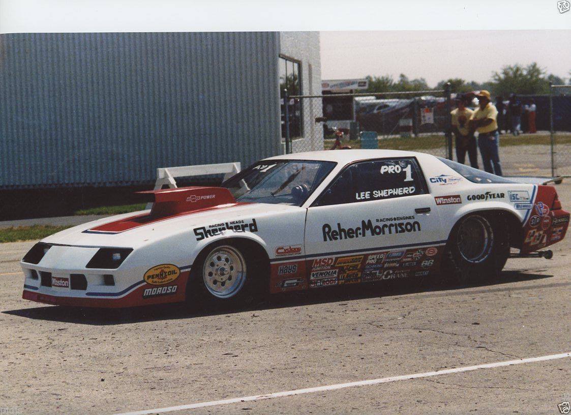

This car was pretty aero..
Name:	Lee Shepherd Camaro.jpg
Adger Smith (Former SS)
