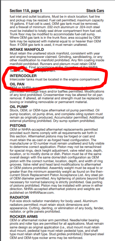

Are you saying that I can run a larger aftermarket intercooler in Stock Eliminator?

I'm saying the rulebook reads this:
INTERCOOLER
"Intercooler tanks must be located in the engine compartment"
I'm not sure how they could enforce a ruling of the intercooler having to remain the factory unit with this rule...
Old 06-15-2018, 08:50 PM   #7
JHeath
JHeath's Avatar
Join Date: Jul 2004
Location: Minneapolis
Posts: 786
Likes: 2,876
Liked 370 Times in 101 Posts
Default Re: 2015 Mustang Ecoboost K/SA?
INTERCOOLER
I believe this is meant for the supercharged CJ, Copo, and Drag Pak cars.
