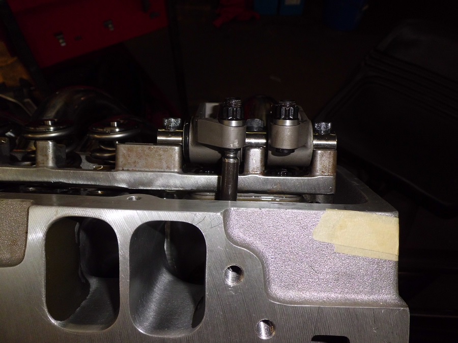

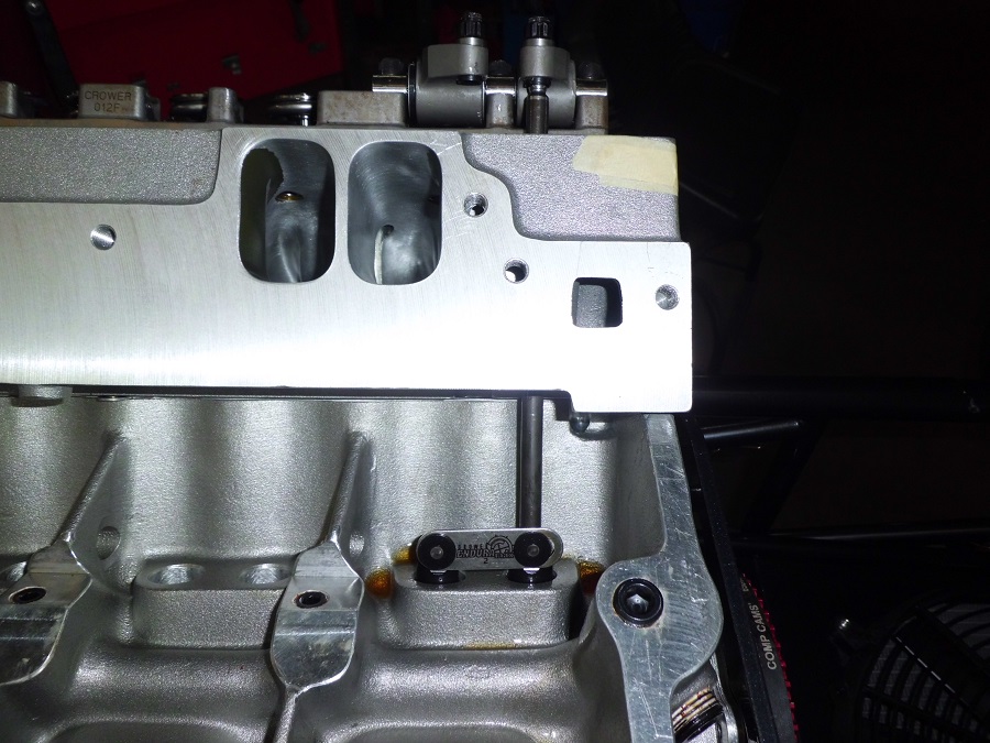

While Monte worked with the Super 10 block I kept busy with the Roadster's rocker arm set up and pushrod length checking.
*Note the intake lifter and rocker offset
*Note the cylinder head height. The head is a Brodix 11 degree casting worked by Kevin Self. As I began checking the pushrod length I quickly realized this head is not a typical small block head, it is very tall. To establish the proper pushrod length required using a BBC exhaust length checking pushrod!
