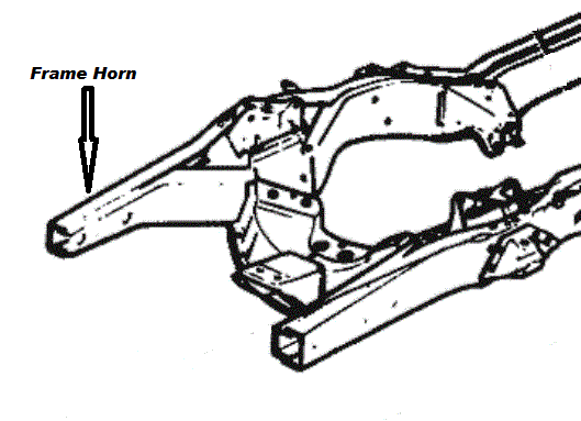

What exactly are they calling the frame horn?
This is called the frame horn. It's the front end of the chassis.
