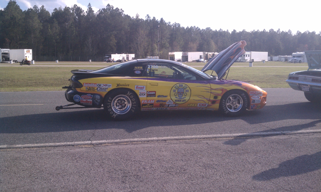

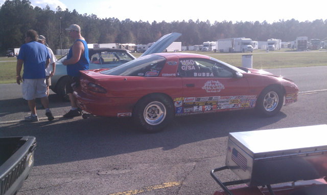

Bubba Linke, the Stock Eliminator winner from Valdosta standing next to his red C/SA Camaro. James Perrone walking around, who knows were his going, he looks lost. Bo Kenny with his back turned and Jim Roberts behind Bo are waiting there turn.

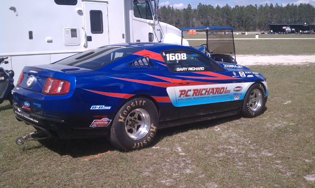

Gary Richard's CJ stocker is absolutely beautiful. His super stock CJ is also just as trick. I will try to get some more pictures of both cars. Still don't know what he is racing this week. His pit area looks like he has way more cars then drivers. GM, Ford, you name it ,Gary's got it.

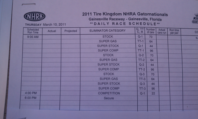

Back to racing, here is a picture of tomorrows schedule. Rain is forecast, so I am not sure will we be racing. I promise after I clean up the trailer to go around the pits and get some pictures. Thanks for being patient everyone.
