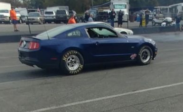

Default Re: 2011 Mustang V-6 Auto
I noticed Steve Stickel has been running a 2011 Mustang 3.7 in M/SA at several D1 races, has run right around - .40 under, car looks good

I spoke to Steve this weekend at Cecil. Cool car and it will eventually be fast. He's got a lot of things to figure out yet but that happens when you're the first one out there doing a project.
