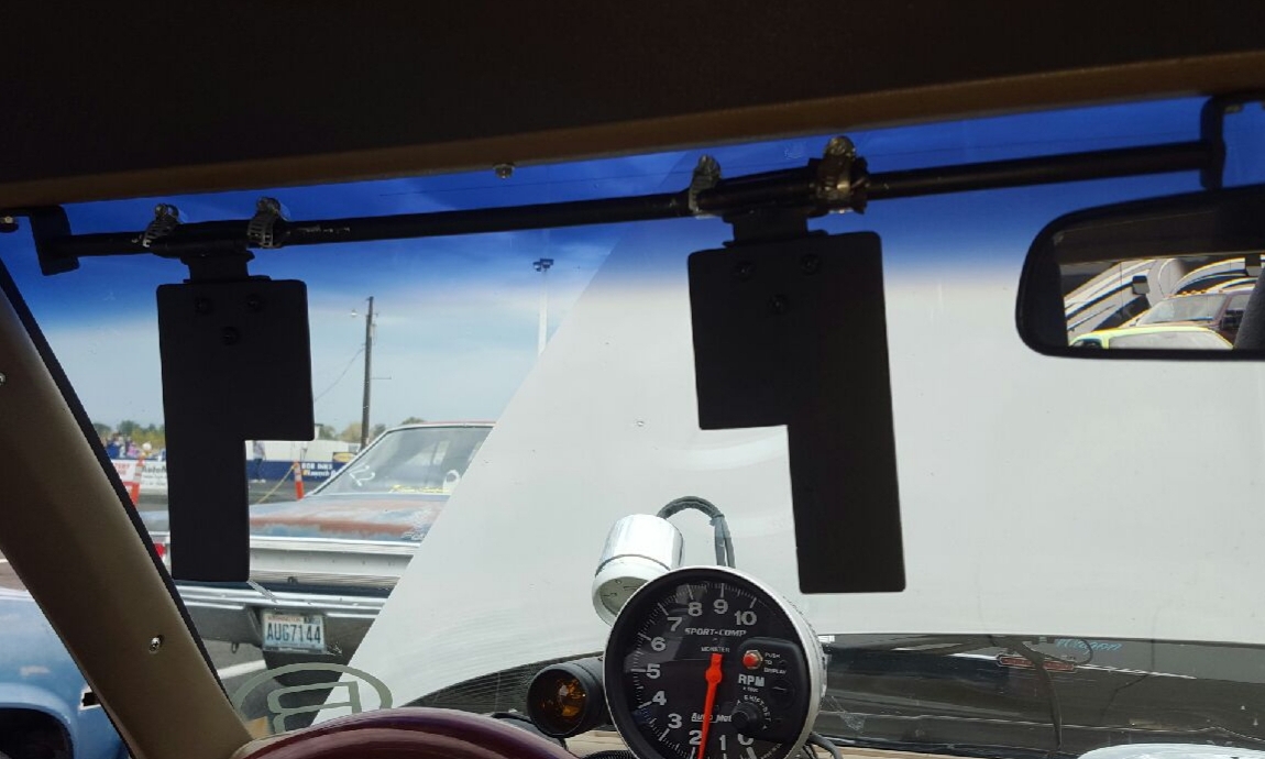

Couple of notched aluminum plates, screwed to a cabinet hinge, hose-clamped to an aluminum rod, screwed to the front headliner valance. There are probably better ways, but this was worked for me for a couple of years now, hasn't loosened up or anything.
