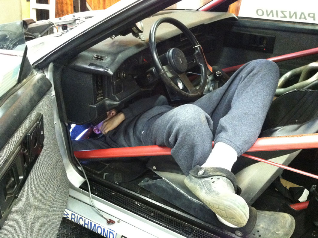

Yep, very big deal. I remember when this came up several years ago, someone wrecked from this and posted about it on here. I immediately went downstairs and 'enlisted' my young son who was far more flexible than me to go under there and check it out. No problem, the bolt and nut arrangement was already in place limiting the back travel of the pedal ('ol Joe Scott knew what he was doing )
