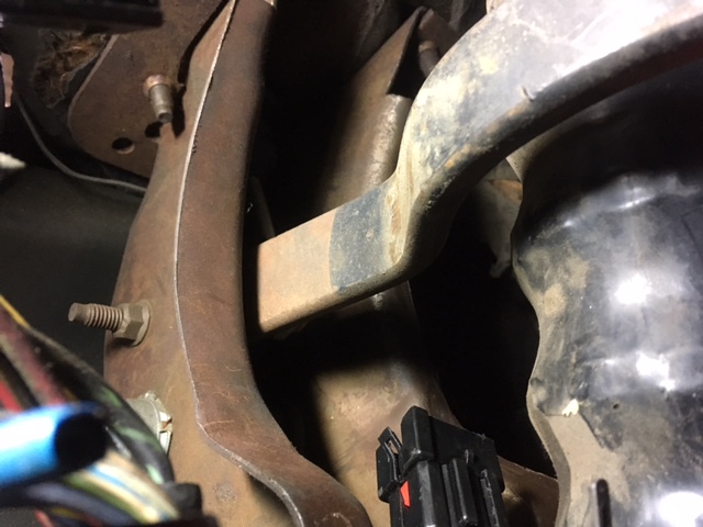

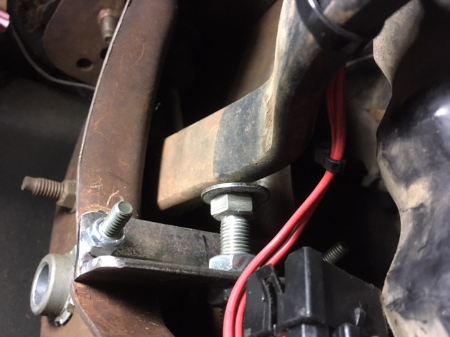

Here's a stop I put on a early Mustang that's in the shop .
Like Billy said ,only a couple of bucks of bolts and stock.
ID:	42493   Click image for larger version
