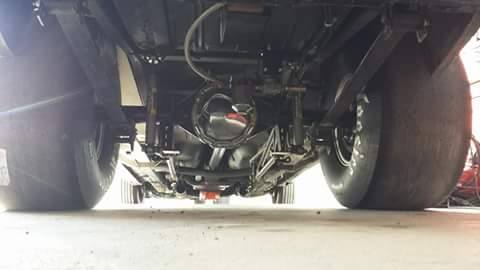

I too have an old Superstock Camaro,I would love to redo the back of my car and run stock eliminator with it, by todays standards its more like stocker than a superstocker except for the fact it has a narrowed 12 bolt and mini tubs.
