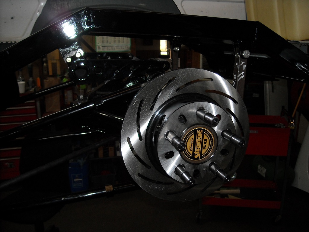

Default Re: Rear disc brakes for 5/8 studs
photo of Strange brake rotor with dual bolt pattern
Larry Woodfin 471W
Thanks guys. There picture looked like the dual rotor hat bolt pattern had 1/2 and 5/8 slotted holes machined on them for use with both sized studs and for height reductions .
