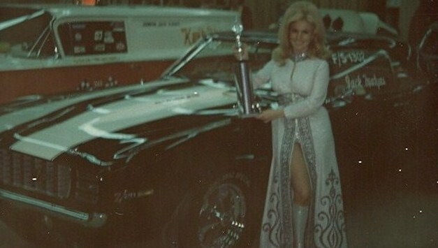

I had a new '69 Camaro Z-28 RS ..........S/S option not available on the Z ................
