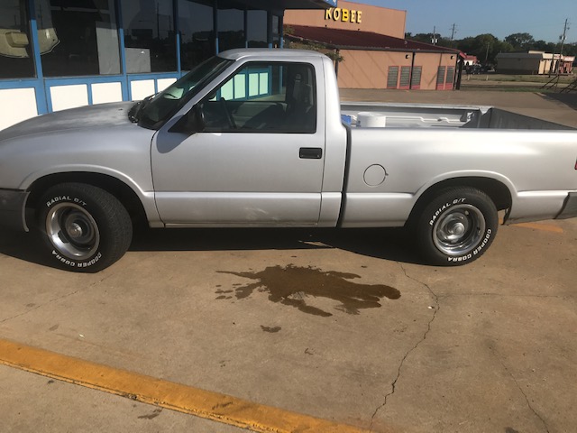

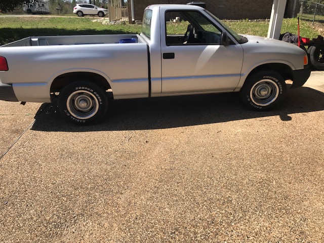

Guys, I do not want the extra work of moving the cab so that is off the list. A 1 5/8 x 1 3/4 is a good idea and I will follow up. I just checked my heads and a 1 5/8 tube will relieve the exhaust port. This is a simple bracket toy for a 6.50 & 7.0 index and foot brake classes.
Just now, I am driving the truck as my trash hauler. It is just about impossible in East Texas to find a suitable "core" of any type. Anywho, it is a 1996 Isuzu Hombre in good condition except for a dirty interior.

Trash hauler
