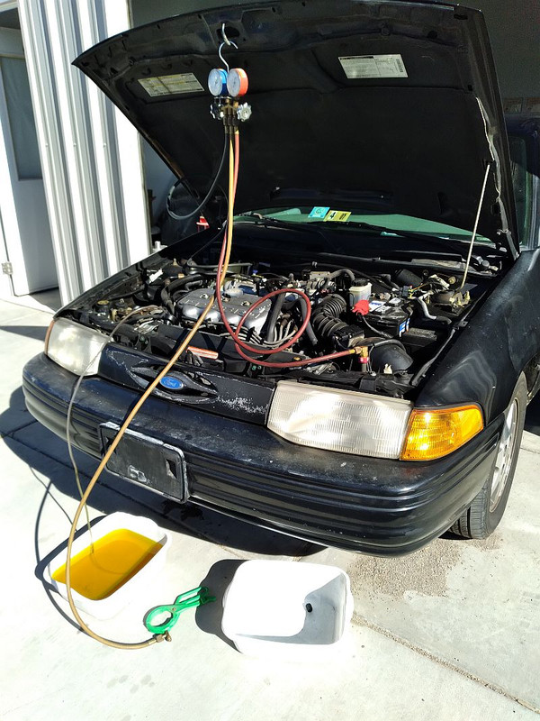

Here we go.
I gotta be nuts..A working A/C car with power steering ,that passes smog..Ripping all that out and throwing it in the dumpster. Don't ask where the Freon went to ;-)
I warmed this thing up first and drove it around the block a few times.I was able to power shift 2nd gear without destroying what's left of the clutch. I convinced myself that it won't take much to run under the index with this car.. But then , a friend reminded me that at the 4600 ' where my shop is, I'm giving up 9 tenths of ET.
...Okay ,so it will run close to the factored ET index.
Stay tuned for more parts in the dumpster. 55 pounds out, so far.
