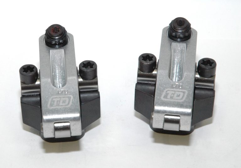

Before we get too far,I looked at the TD site.Do you have the 16 individual stands that mount over the rocker stud bosses and are held down by a 7/16 NC bolt,thus eliminating the rocker stud?.By doing that you have converted it to a shaft rocker which may not be legal.Maybe someone here can chime in.Also I'm assuming you have a solid lifter BBC stocker,with the cam profiles for that combo your going to need well north of 450 open pressure.If the cam is hyd.400 open is in the ballpark with a ceramic lifter.About the valves loosening off,I don't know how your adjusting the valves. If it looses a lot after adjustment I would check if the cam lobes are not wiped...gsa612

The stocker rules say rockers must retain original configuration and aftermarket rockers are permitted. The Jesels are shaft conversions but the T&D set for 396 Chevy OEM heads look like pedestal replacements. Each rocker is bolted to the head separate, but secured by two bolts so they won't wander. Kind of a rulebook grey area that could bite you. Send a part number and pic to tech to get a ruling.

3nine6,is this what you have?...gsa612

Well, it uses a stud, but it actually bolts the trunion shaft of the rocker down to a saddle. It AND the T&D are both absolutely legal, and the best solution. Yella Terra makes a set as well, They're excellent, and they should also be legal.

The T&D solution looks nice. A base bolts to the rocker stand and an individual shaft rocker bolts to the stand in two places. No wiggle and the adjuster is at the cup. All of these better mousetraps are north of $1200, but Jesels solved the valve train problems in my N head 302.
