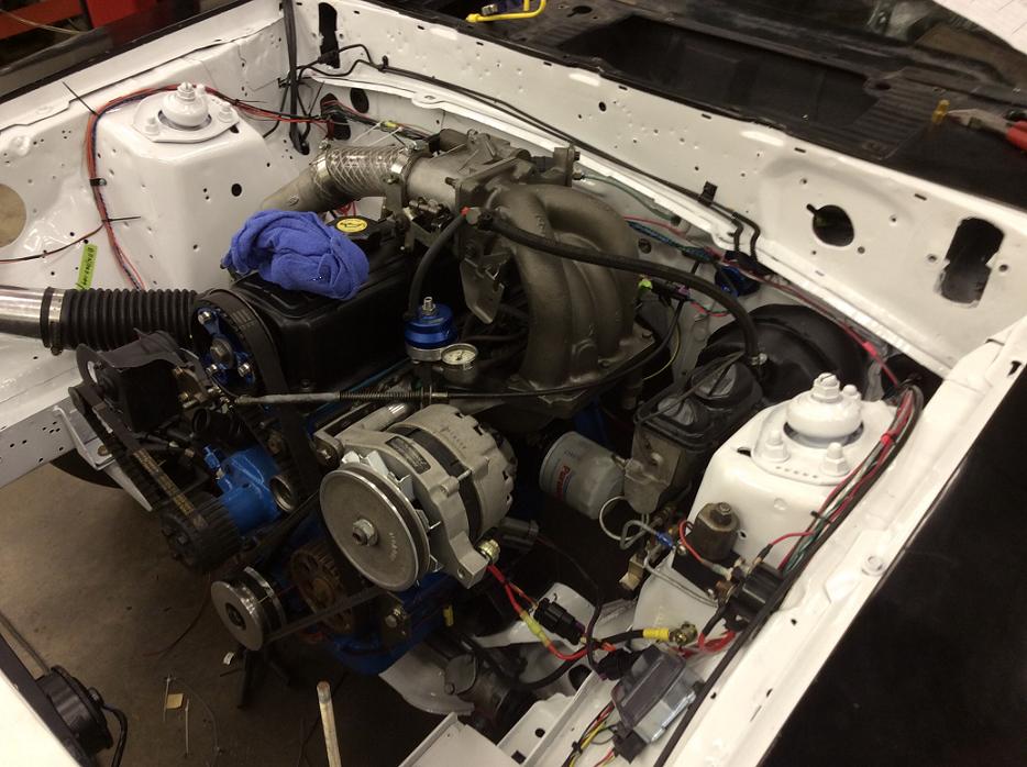

This is our 1984 GT turbo stocker build.. It started as a dime rocket but was an original SVO and we didnt really give it a chance with the stick.. .. Now we are going with the GT Turbo for the auto .. Should be interesting to see if what it will run when we get it going..
Scott

The stick deal requires a lot of gear and/or transmission to wind it up. Mark Walton had a killer 83 stick turbo, but it did not happen overnight. What were you using for a trans and clutch in J/S? The SVO deal is way over factored which is sad, cool cars. The intercooler does not help it that much on the power difference between intercooled vs non-intercooled. What gear do you have for the rear? You should be able to get the car down to the min weight too, it just takes planning and fabricating to get there.
Cool stuff!!
Sean

We used a t5 that I worked on.. It seemed fine at 6500 rpm but it was noisey getting it in gear and around the pits.. It had issues keeping boost up after you let go of the clutch.. I had installed an aluminum flywheel and that might have been the problem.. I have all the SVO stuff so I want to try it again.
You are correct the inter cooler doesn't help that much but it is way over factored.. It will be tough to run 11.40's at 2930 pounds .. Now it can go from 2560 to a little over 3000 pounds and N - Q depending on year.. So it makes a lot of sense.. We have a worn out engine right now.. And a bone stock 120,000 mile turbo.. Won't have our rebuilt one for another month or two.. $$$$

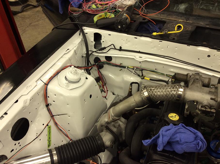

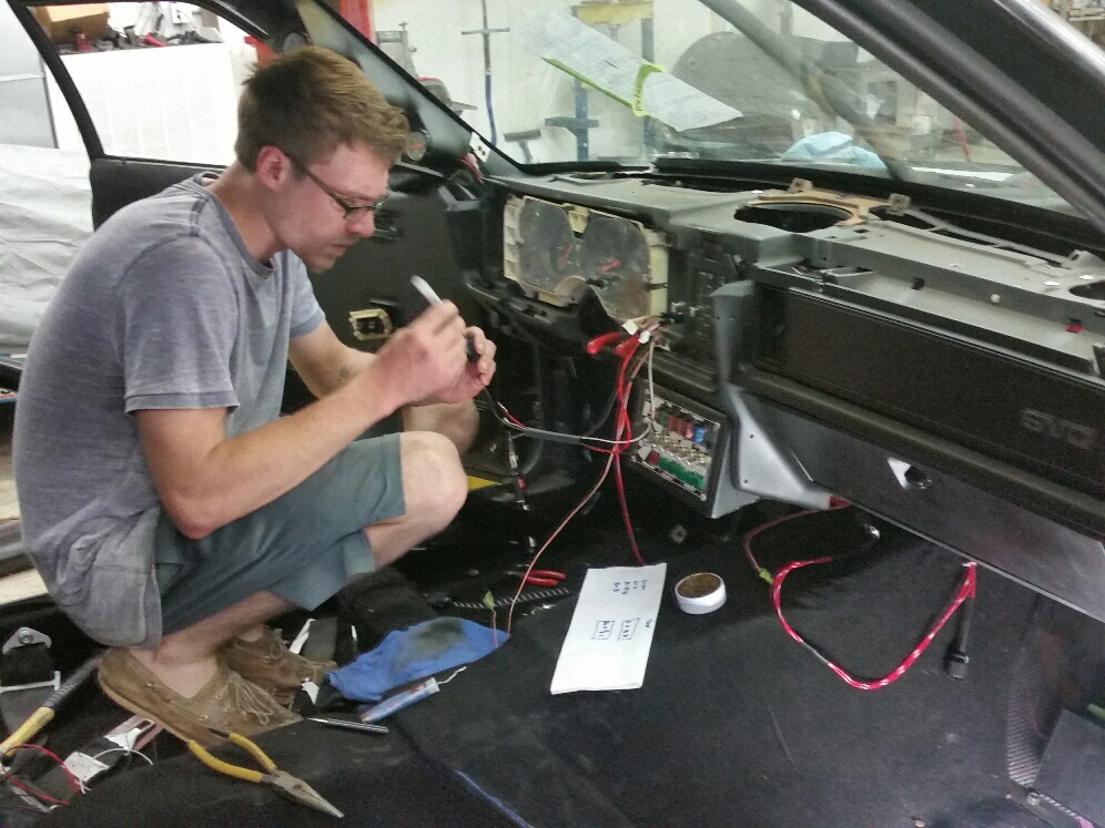

Here is this weekends work.. Its all wired and connected under the hood. Dad and Nicko did an amazing job making it look very neat.. It wont be long til we fire it up.. The interior wiring is ready for the dash and control panel and Gauge hook up then we ready for carpet.. and interior.. Coming along slowly..

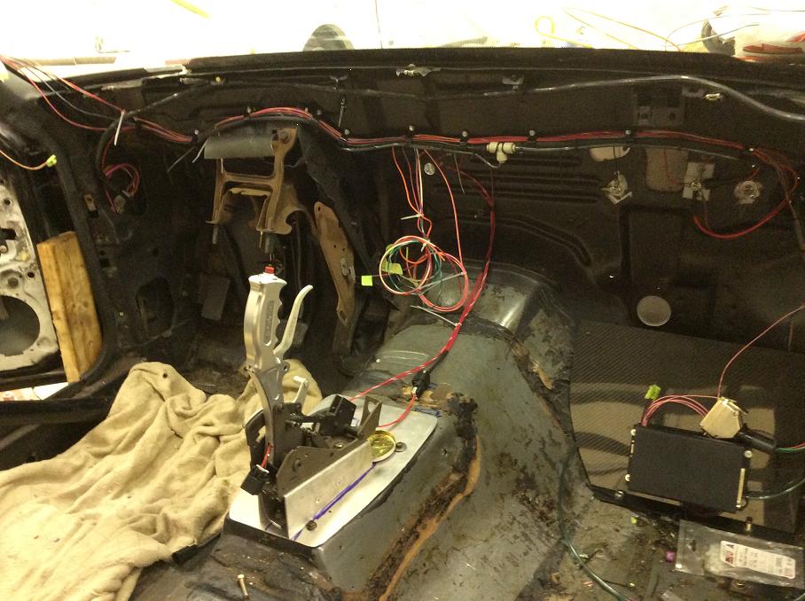

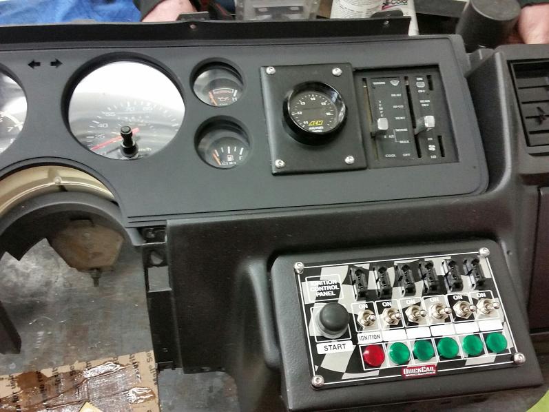

Weekend update.. We completed dash install and wiring then we tested all wiring and Dad did his wiring masterfully.. We had 1 relay that was new but didn't work. That's all that that did not work, all sensors everything else worked fine.. were are gonna build the C-4 this week and try to get the car fired this weekend.. Carpet is in and waiting on interior install. maybe get to test a week from Tuesday if the idiot(me) computer guy can get it started.. I will send more pics this week

Wiring finished... Rebuilt trans and installed new valve body, installed steering column... Should fire it this week
