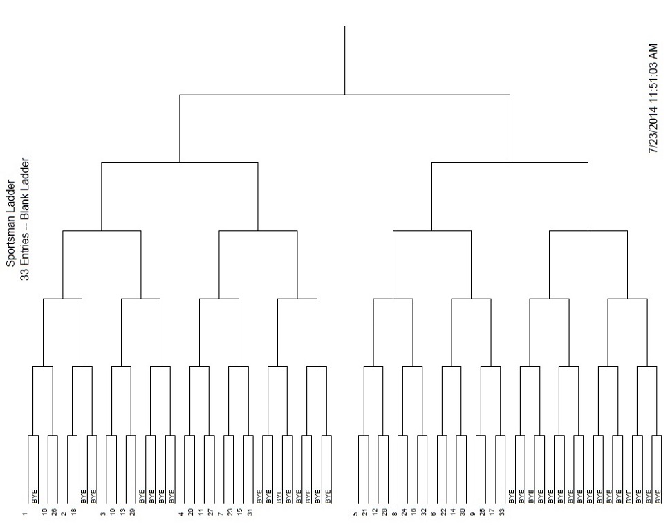

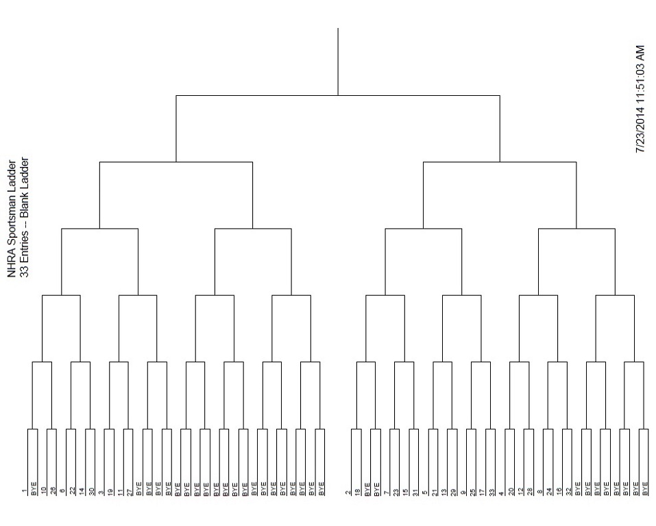

A good example is the NHRA 33-car ladder. In this ladder, the #1 qualifier will get a bye in the first round. If the #1 qualifier is still in, he/she will also be eligible for a bye run in the fifth round.
The attachment "NHRALadder_33Car_alt" shows the 33-car ladder currently being used at NHRA events. The attachment "AltLadder_33car_alt" shows how the 33-car ladder could be setup to prevent this from occurring.
