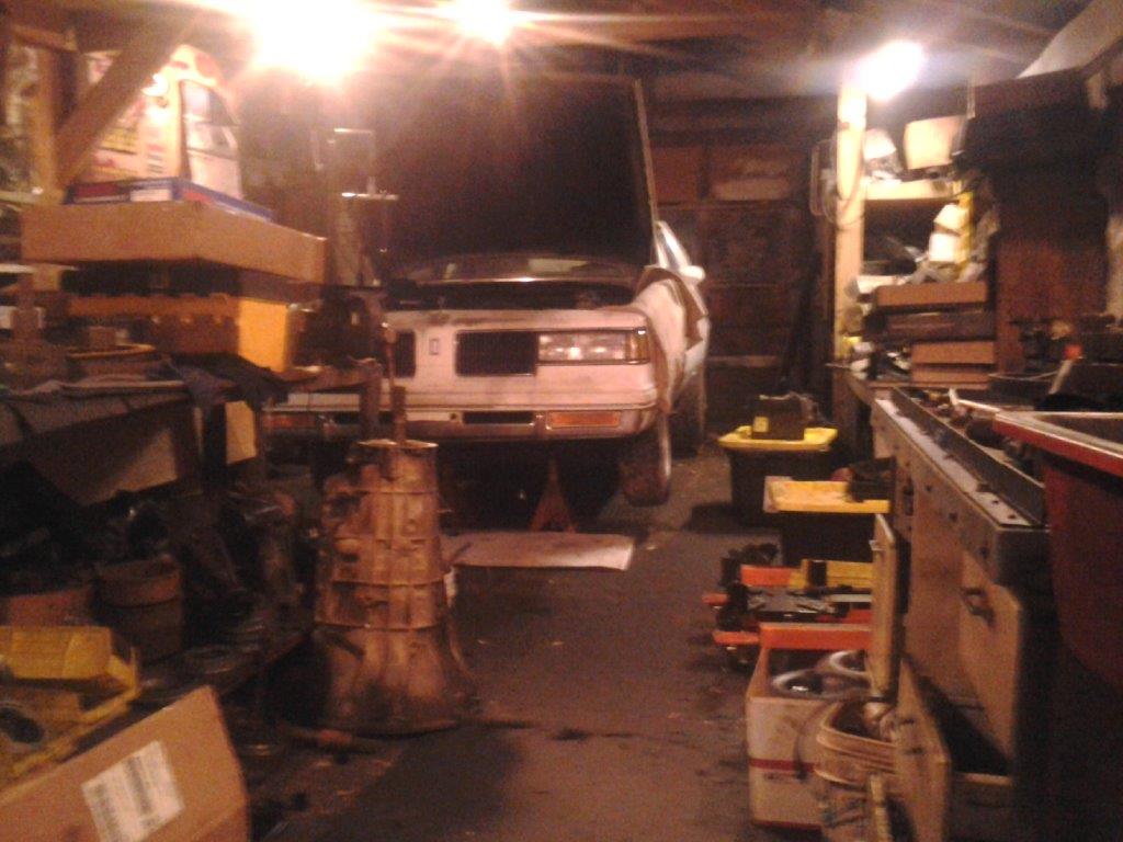

Hello, my name is Chris Lindell, and I am a newbie to class racing. I am building a 1987 Olds Cutlass Salon to compete in IHRA I/PS.
My goal is to see how far under the index (14.55) I can get with a combination most people consider junk and throw away.
307 cid engine
200 metric trans
7.5" rear
I am also very cheap by nature, and do not like spending a lot of money on this stuff. It will be a fun challenge!!

Understand your POV.
Racing is not cheap..
However the car is the least expensive.
It is the travel, pit fees, and motel.
The 307 is very popular especially with a QJet.
Your rear is strong enough, parts are available.
Engine, Trans, rear, and converter with be your largest investments.
Ping Billy Nees...

Send the money to venolia for replacement pistons - you cannot due without them! 4.56 in the 7.5 is plenty. Have fun

LOTS of G body stuff here:
http://www.maliburacing.com/
http://gbodyforum.com/index.php?sid=...b#.U3p6K5VOW00
If you are cheap (isn't everyone?) you will find interchange info for 7.5 gears-rearends-steering-suspension and more.

Hey Chris, welcome in!! I'm in the same boat as you but a lil farther along. I have a 93 Z28 that we built up and are running in D/PS. Bought the car last September from a bud who was footbrake racing it and we went to town. So far I have done headers/muffs, stripped a ton of stuff, great FTI converter, a 12 bolt rear swap (broke the 10 bolt after about 40 runs), good computer tune, etc. So far we have been .39 under with a bone stock 160k LT1. More importantly the car is a very good footbraker, I have been as high as 4th in div 2 points and just scored a R/U at the last Southern Stock/Super stock combo race. This car is going to be a first big car for my oldest son who is about to graduate from junior dragsters. I have about 6k total investment in it and on a fun per dollar scale this car kicks *****!!
PS. I have a near new 4.10 gear and assembly kit from my 7.5" 10 bolt that I'll make you a killer deal on if it will fit your rear. Mine broke the posi and I already had the 12 bolt standing by.
