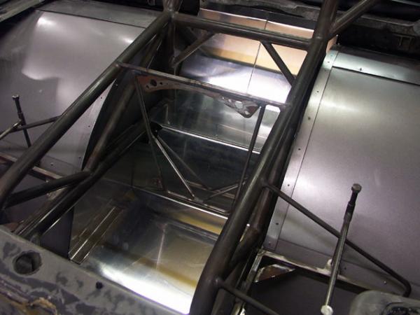

Before making the chassie ready for paint we fabricated all sheet metal/cover plates etc. The body it self is in composite, but in some areas we had to use 2 mm aluminum to get realistic function and fit.
When that was done and we were sure everything fitted perfect it was time to prepare the Viper chassi for paint. We stripped everything and left was a bare skeleton...weight about 350kg (800lbs)
