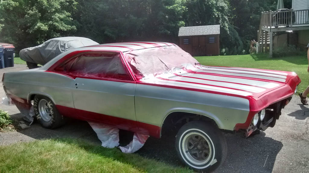

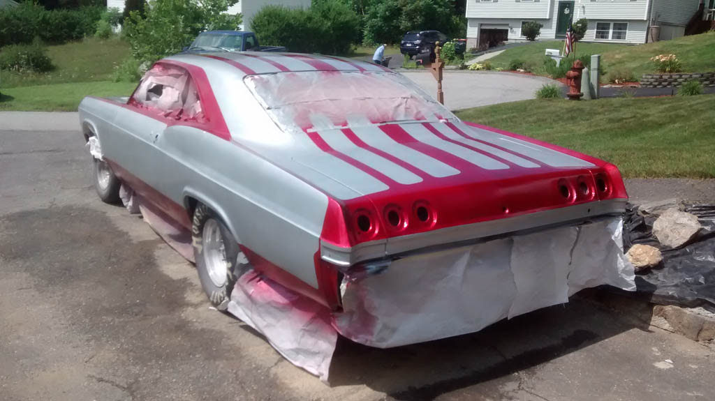

Today I am building a 1965 Impala Stocker I/SA 396/325 It would seem to be a Modified car from 1971 with all tha stuff we are allowed to do (or get away with?)
I gave the car a Nostalgia paint job since i will also be racing in a Nostalgia Program too.
( N.E.T.O. ) Northeast Timing Organization
All metalflake too!

PIcture of the car are in my Class Racer Build section.
http://classracer.com/classforum/showthread.php?t=48228
