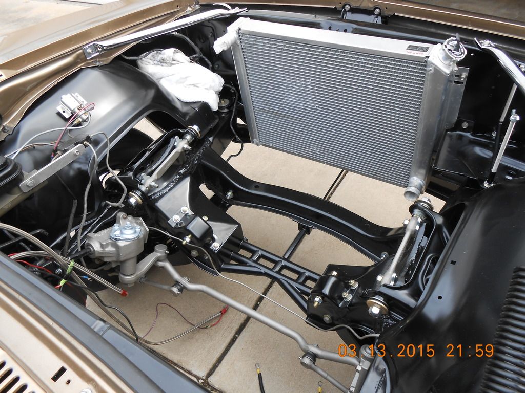

Originally Posted by impstocker View Post
Nice Build. Question, are you using stock rubber bushings in your front upper control arms?
I have solid bushings in my Impala, used solids in bottom too. Am I too "old school"
Will Lamprecht 1965 Impala I/SA in progress.
Yeh just the stock bushings upper and lowers and the teeth ground off . Front end will be loose as a goose I was gonna buy the high dollar stuff but my uncle set up these and we decided no need to spend the extra bucks when it'll be just as loose with the stockers and some tricks.

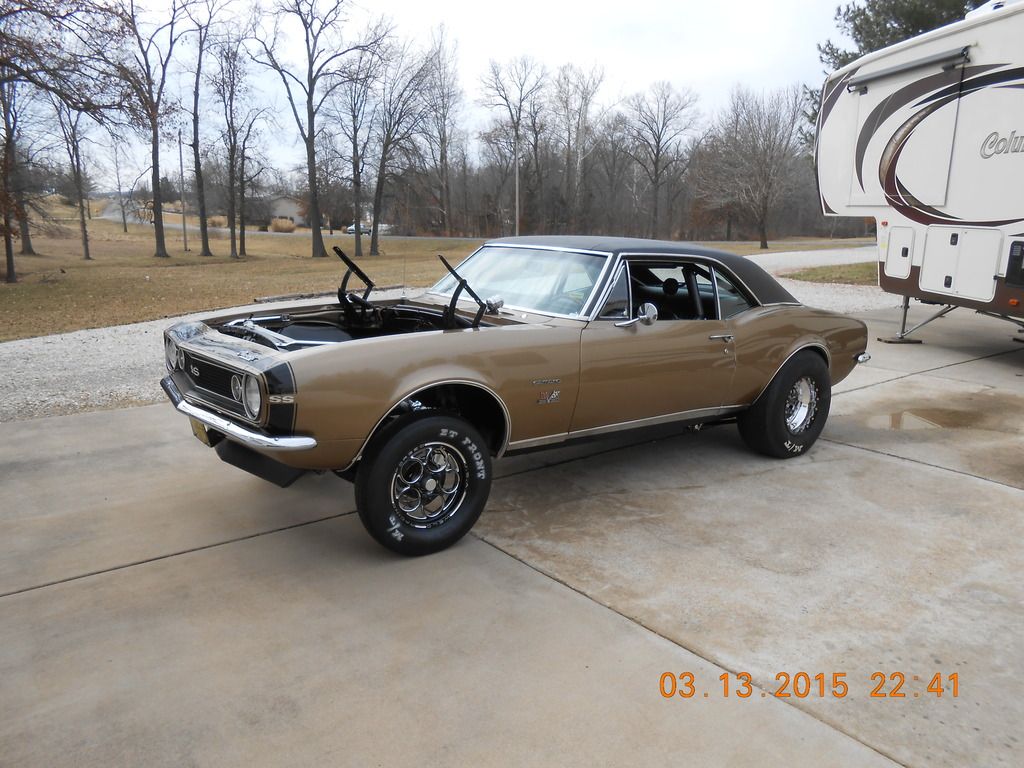

Pics of Tim's build from today. Didn't get much done but Tim's feeling alot better.
Rolled the car outside and took some pics.

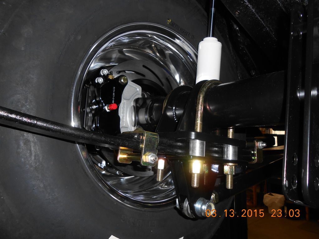

Progress Part 2
Inside of rear wheels.

I am feeling a lot better still be awhile before I can turn some wrenches , but my new wheels came in for the rear so I had to talk my buddy Garret into mounting them and my Dad to put them on this weekend (thanks guys)I had to see them on the car!
I also have to say Sander engineering makes an awesome product they even polished the inside of the wheels and anodized the centers and Beadlock rings and machined them just like I asked and they look awesome!
The car is really turning out nice and I can't wait to set the motor in it and get it running!

Tim and Garrett working on the brake lines

Tim, I see the shifter is gone now...you changing it over to a "3 on the tree"?? Ha Ha! Looks very nice. I really want to redo my spring perch / U-bolt setup after seeing yours...

Yeh Paul that's the new air shifter they are pretty neat lol . I'm waiting till I get the trans in to cut the hole , because it's new carpet.
The rear perches are the way to go for sure no more bending plates when this thing 60 foots. 1.19 on the rear tires lol j/k lol!

The car looks amazing!!!!!!
Congrats and thanks for letting us see it.

I really like the crossmember cut out and rebuild with the round tubing. Very nice work. My question is that legal on a stock eliminator car?
I also asked. Yes, it is in the book under Stock Eliminator "Oil Pan"! 10A page 5.
Real nice work!
