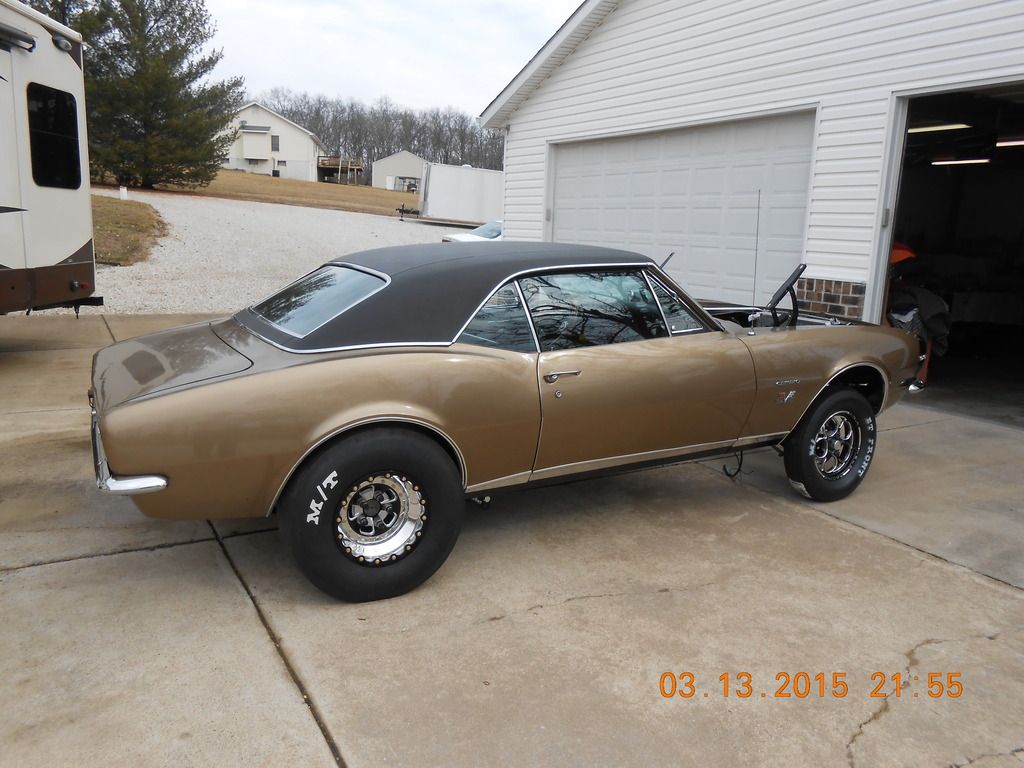

Default Re: 1967 camaro A/S project
Matt,
They are 15x10 with 5 inch backspace . The tires are Mickey Thompson 29.5 x 9.0 x 15S

What a beautiful tire package ,just like the tire on your red stocker you had,man that is gona be hard to decal that thing if contingent money is in the plan,super sharp stocker ,you do nice work,what are you aiming at .8 to 1.0 under

If it'll go 1.00 under I would be ecstatic! This combo has been beat to death for 40 years lol not the smartest to run a 396/375 hp alum head lol. More of a cool factor for me ,just want it to be respectable . It'll all be new so it'll take a lot of sorting out , but it'll be a lot of fun to drive!
