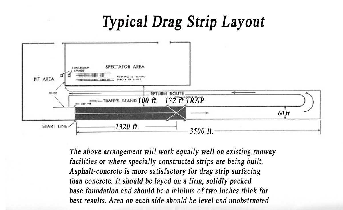

needs numbers [in feet] please. from your experience, what you liked, didnt like, what you would do if you could start anew.
Concrete: [bracket cars to Alky dragsters]
how far behind the starting line would you start.
how far past the starting line would you go.
how thick [normal driveway concrete is 3 1/2"]
Asphalt. for 1/8th mile.
how long would the shut down be?
Lanes
how wide are 'normal' lanes?
how wide a space between lanes?
any other thoughts, please include.
thanks Rod in AZ

I have a digital copy of old NHRA Rule Books. The 1958 issue has a design and procedures section with this diagram. I replaced the washed out type for readability and some of the numbers may be off.
As Wally saw it:
Name:	1958 drag strip.jpg
