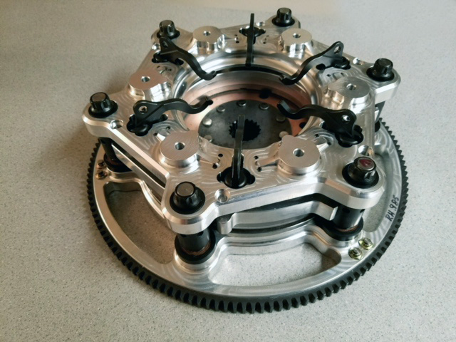

Hi Kirk, here is what the new 8” looks like. The new design 8 is meant to be more forgiving than previous models. The thought behind them is you can slip them more on the line and the clutch having more levers on it, it allows it to catch back up. So it should be a really good clutch on marginal tracks. Also it’s light weight like the 7 that is being referred too. I believe it’s same or lighter. You would have to research that. Don’t think the cost is much different. Good luck with your program.

Last edited by Z28-69; 03-21-2018 at 03:17 PM. Reason: Trying to post pic of our just purchased one. Can’t figure out how
