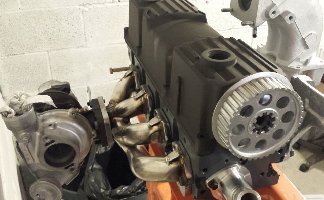

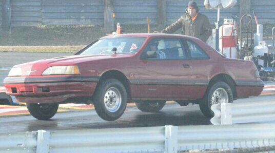

As some of you may know I bought Ken Robinson's 88 turbocoupe stocker,I made it out to the track once before it closed for the season, it only went 14.80 @just a weak 88 mph! not very impressive but it has tons of potential,im changing a bunch of stuff over the winter and hopfully i can get it to run the R/S index of 13.95, so far I took the head off and had a stocker valve job done along with some new valve springs and retainers.,a new 3" down pipe and a header, I think it will a fun project for now im going try and run the index on the cheap and see what happens.
