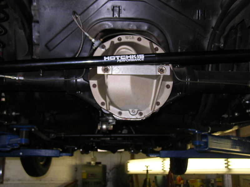

Hope his helps.Cr

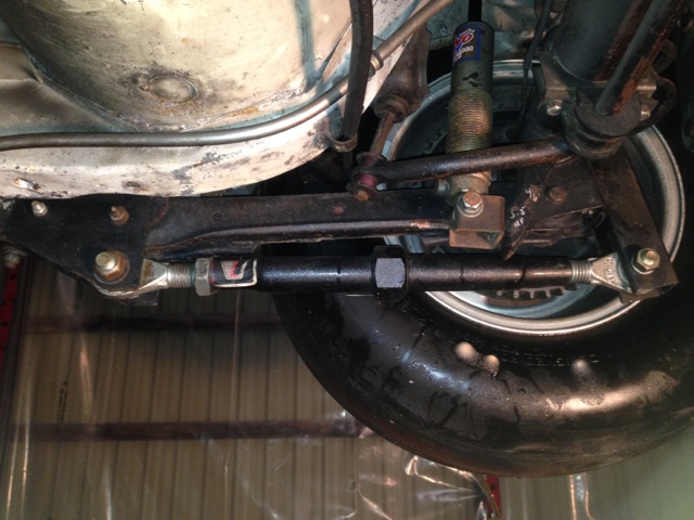

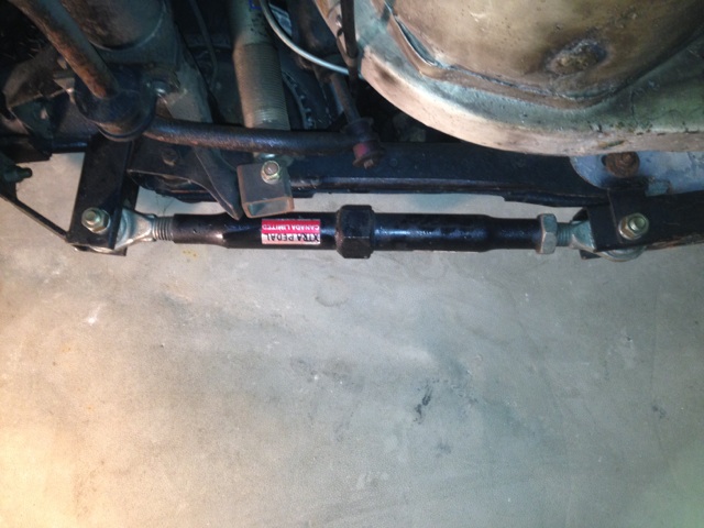

These are pictures of the traction bars I built for our car.
Are those the top link of a 3pt hitch for a farm tractor?

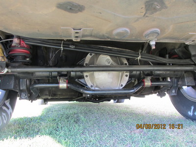

My Formula. I tried several different types of traction bars and found that the car worked better without them.

Default Re: 82 to 92 Camaro stocker pics
Are those the top link of a 3pt hitch for a farm tractor? LOL Maybe ! they work well solved the problem---Trevor
