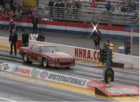

So did the camera flash cause Mason's red light?
The next frame in the video shows his red light come on.
I assume the starting line reads from the outside the same as the downtrack lights.

Old 04-20-2011, 06:31 PM   #4
Pat Joffrion
Join Date: Dec 2003
Location: Bayou Country, Louisiana
Posts: 163
Liked 6 Times in 2 Posts
Default Re: Red Light Answer
Quote from response by Mike Rice: "The shallow stage deal is very real, especially without the StageLoc program."
From Reading Mike's reply, it appears that Stage-Loc was not used. I was under the impression that all national event tracks had it installed years ago. However, it has to be set to be "ON" for each category in the tower computer.
If it was not turned on (per Mike's reply), then someone in the tower screwed up! Since the stage beam are recessed at least six inches inside of PVC tubing with less than three-eighths of an opening, I don't believe the camera flash could in any way reflect into such a small hole to reach the receiver.
Conclusion: Without Stage-Loc operating, the slightest movement of the front tire more than likely caused the red light. Kind of sucks to have the software disabled! I would recommend that someone needs to verify that it is enabled for stock and super stock at each race.
This seems like an intresting subject. I can't figure why the red comes on at the second yellow when the car appears not to move at all, it doesn't appear to even be loading the convertor. When I watch the video over a few times in full screen, you can see the flash reflected on the pavement. Since he has polished or chrome wheels it seems possible the wheels reflect the light causing the eye to read that the car has moved.
If this wasn't possible why do a lot of cars have the ugly flat painted front wheels.
Mike,
I didn't fully answer your question, so here goes:
The Stage-Loc and starting beams read only from the center of the starting line ... Not from the outside (as is the case down track). Actually, there is no outside lens for the Stage-Loc beam!
From looking at the photo, it appears to be impossible for the flash to go through the vehicle. Before I built my own track, I used to put shoe polish on the front rims because the starter told me that the bright sunlight might' ve caused my red light.
I found out the reason after investing millions. You guys get for free. Trust me, I know how it works and am glad to help answer your questions. Now, if someone can just explain to my wife and I the reason we have to bury our son tomorrow...
Chatting on this forum helps to get my mind off Philip's death, at least for a few minutes. Thanks for listening.
Originally Posted by Bernie Cunningham View Post
As far as I know, that type of sensor is no longer used, as in where light reflections or flashes would cause them to 'switch'.
These days the units are a sender and receiver across the track and must communicate with each other to 'switch'
So when the funny cars take out the 1/8 mile and finish line foam blocks there is not just a reflector in the blocks but a receiver or sender?
Did it use to be just a reflector? maybe that's where the idea of wheel reflection got started.
Camera flashes for an instant are very bright, I hate the annoying flashes from overhead strobes at NBA games that are triggered by the photographers camera.
If I watch a replay in slow motion it will white out my tv screen.

If the starting line beams read from the inside it doesn't seem possible that the light from the flash caused a false reaction. He would have to have been in really deep or really shallow to cause it to trip since the Stage-Loc was not on. (Assuming they have Stage-Loc at Pomona)
I raced up and down the West Coast and found all kinds of ways to loose but this one was new to me.
On another note - I am truely sorry to hear of the loss of your son. My son is only 13 and I can't comprehend what your family is going through. My condolences and exta prayers.

I dont know the equipment at Pomona but what I know the reading device is in the middle on the starting line and when the car is staged it would block the camera flash that is shown in the video. The camera flash may have shined onto wheel but its the wheel facing the outside portion of the lane and would not interfere with the sensing beam. Now the rest of the increments down track have a reflector in the middle and the reading sensors are on the outside of the lanes.Doesnt solve the problem here but I think I would rule out the camera flash. As Don described his problem in WY I would have liked to have seen the tree activate again as the Camaro was still staged when tree was cleared just to see if car was at fault.Just a thought: if the beam is .030 in diameter and the wheel rolls just enough lets say .030 and keeps beam from crossing track and the car would move backwards (somehow?) say .001 then the beam is now uncovered and would register as if nothing was on starting line and go red. Cant be seen with naked eye. Sounds pretty far fetched but maybe.
