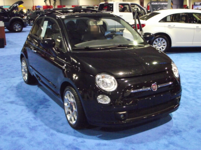

I examined one of these at the NC International Auto Expo this weekend. Quite a nice little car. It would be interesting to see if Chrysler would want to attempt to get it accepted in the Classification Guide so it can run Stock.
