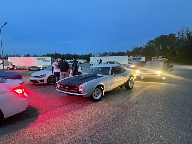

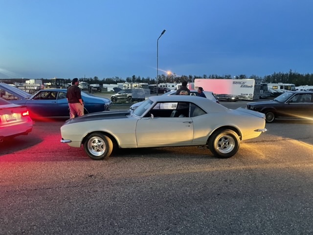

I just assembled this car this year for a street strip deal, but I am thinking I might make a stocker out of it.
I have looked at what combos I can choose from.
At this point I am looking at keeping it a automatic.
So probably choosing between a 350 build or 396 build and if there is any advantage to a 327 I would look at that also.
Can I get some input on the pluses or minuses of those combos, trying to decide which way to go.
The car is a 68 with all new panels I have not had time to cut the marker lights in yet.
Thx in advance.

Try a pic one more time
When I preview post there always upside down.
Even turned upside down in my library before uploading and again they come upside down when I preview haha think it worked this time

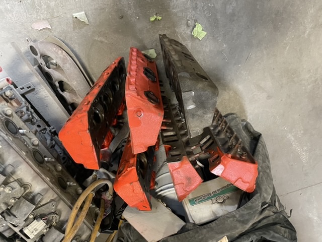

Ok so 295hp 350 cid it is with a auto
So started gathering parts, picked up 3 sets of correct number heads with no previous work done to them, so will see which are the nicest for starters.
