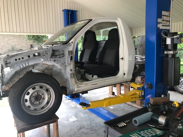

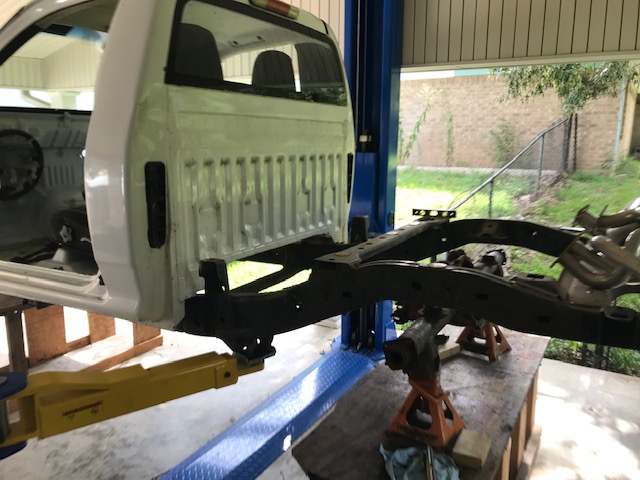

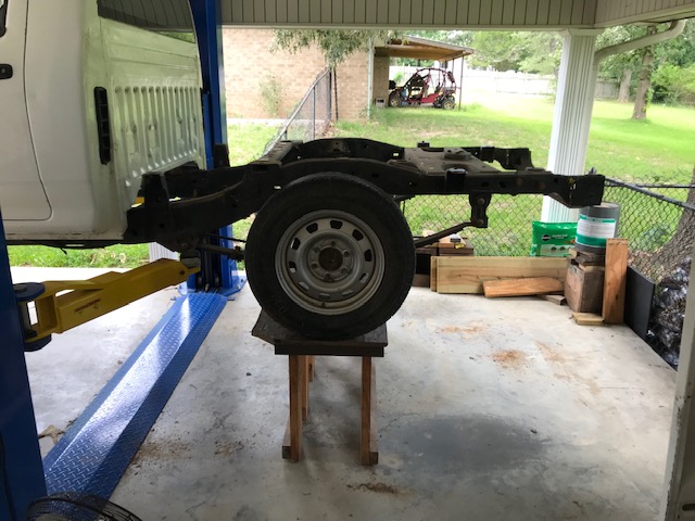

Working on a truck is a beautiful thing! Remove the bed, complete access to modifying the rear suspension. After a time of thought, I plan to install a set of ladder bars. They will do everything I want in this situation. I will also install them about 4" inboard of the factory frame so that if in the future I want a larger tire it will be an easy upgrade. Installing a Chevy 12 bolt will also be part of this exercise.
Here she is on my trusty, home-built tables that allow placing components at ride height and allowing a good view of the fitment.

Some notes, as I begin this project, I recognize the Colorado/Canyon as a good package. It has a full-frame, rack and pinion steering, coil-over front spring with a-arms, it is overall about 3" wider and 3" longer than the S-10. I expect it to be a very nice footbraker.

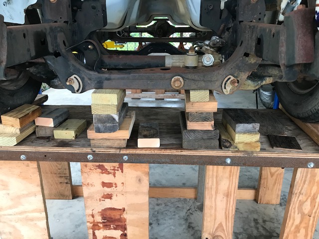

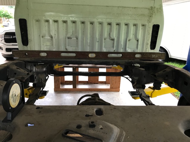

Old 07-11-2021, 12:10 PM   #6
Dragsinger
Join Date: Jul 2008
Posts: 1,760
Liked 99 Times in 60 Posts
Default Re: "Family Tradition" a build for Daughter & Grandchildren

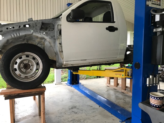

In the first photo, the front springs are removed so the suspension can be blocked at ride height.
The second photo shows the chassis blocked at one degree forward rake.
The third photo shows the chassis blocked level.
