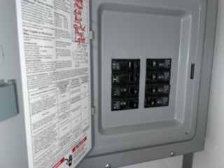

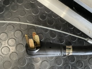

Here is a photo of the trailer plug and the fuse box.

Old 01-11-2021, 04:05 PM   #9
johnk1872
Join Date: Dec 2009
Posts: 38
Liked 15 Times in 10 Posts
Default Re: Trailer lights and plugs no power
thats a 50 amp rv plug, you can get an adapter 50 to 15 amp at a rv stove .plug into a 120 outlet and you should have pover to your outlets

Old 01-11-2021, 05:46 PM   #10
voltdr
Join Date: Jan 2008
Location: Texas
Posts: 706
Likes: 77
Liked 100 Times in 51 Posts
Get an RV adapter pigtail. 50A-125/250V to 15A-125V then your 120V panel will be powered up.
