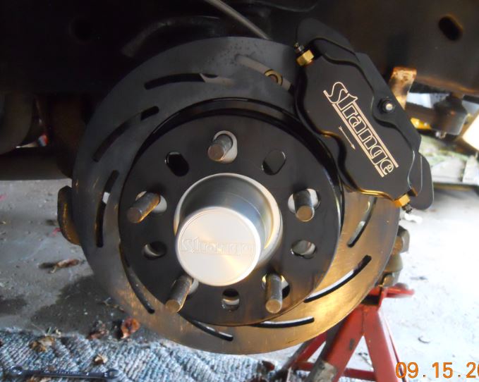

I just finished installing Strange front disc brakes (B4116WC2) and Strange Dual caliper rear brakes (B1718WCD2) on our Stock Eliminator car. I have been bleeding brakes since 1975. I could not get the air out of the system to get a firm pedal. The top caliper on each side of the rearend has horizontal bleeders. For sure there is a void with air inside the caliper above these bleeders. The first picture shows what the calipers look like when they are installed on the caliper brackets. Bleeding the brakes this way just does not work.

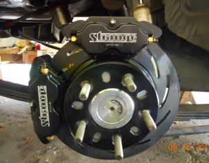

The second picture shows how I zip tied the top caliper so bleeders on both calipers are pointing straight up. On the first bleed I got spurts of air. In a couple minutes the brakes were bleed and the pedal was firm.

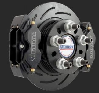

The third picture shows the front brakes. The bleeders on the front brakes do not point straight up but they bleed just fine while attached to the caliper bracket as shown in the picture.

It's so easy a caveman could do it......
This is a trick from 1965 when Corvette made the transition to 4 wheel disc brakes...
Unbolt and remove the caliper from the mounting bracket with the brake line (hose) still attached, place a piece of wood or any other material between the pads and while your apprentice pumps the brakes up all you have to do is turn the caliper in whatever direction is needed so that the bleeder or bleeders face up and bleed the brakes as you would normally do..
I guaranty that you will be able to remove 100% of the air that is trapped in the caliper....
Just another old guy trick........
Just sayin'
