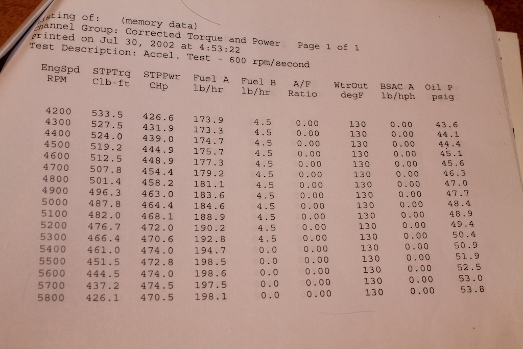

A few years back I bought a 1971 Buick GS 455 stocker 315/330 HP. After taking delivery of the car I rebuilt the rear suspension, changed the fuel system, rejetted the carb, put on fresh tires and headed for the track. I was surprised when the car ran 11.35 on a 11.85 index (F/SA) on a 2130 foot track with a 27.80 baro in July 4500 DA, although the car was 135 pounds light for F/SA. I put the car away for a few years but couldn't help but think the car had potential if the engine was legal. This last week I got the car out of the garage and pulled the engine and put it on the dyno, then a tear down to determine what I was working with. I will post pictures of my engine build as I go, I will be looking for 30 extra HP out of the engine, if I can get that I will then look very hard at the drive line. I can't help but think if I can get a few hundred more RPM peak out of the engine I can then gear up to a 4.30 gear with more converter. Any advice or information on this build will be appreciated. Dyno test as the engine was pulled from the car.

Default Re: 1971 Buick 455 GS F/SA G/SA Build
Got any more dyno pulls with a broader range of rpm? Ie lower and higher.
I do have some tests I started @ 3800 but If I remember right I ran the car from 4200 to 5800 on the track. I really didn't want to run it past 5800 until I went through the engine, after its freshened you can be sure it will be run much higher than 5800, in fact I need more RPM to make the driveline changes I want to make. I do have the top end off the engine now and everything appears to be legal. When I look at whole combination of car and driveline and engine I can't imagine not being able to make it faster. I will mention while testing I leaned the carb down, I had a 67 jet with a .062 rod and it picked up from the race setup and I had no jets or rods to go leaner, I test @ 6400 feet elevation. I will look and see if I printed any of the tests starting @ 3800 RPM, if I have them I will post them.
Keep in mind I NEVER get in near sea level conditions. Glenn you've seen the previous dyno data how would run the gear stack? Gear ratio is 4.10 12 bolt.
Ron, The 455 Buick has a much shorter stroke and a bigger piston.
Just sayin'
I agree, in my line of thinking, first I need to get the car out of the hole, more gear, more converter, less internal trans weight, at this point I can deal with the first to second gear drop, but a 1.53 60 not going to get it done, theres lots more there. I believe a 4.10 gear could work in a 29.90 baro but I never see that. So with a 470 CU IN engine with head flow in the 220s @ 28" I think I'am going to concentrate on the heads and intake in that order after the short block is freshened with a modern ring pack.
