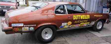

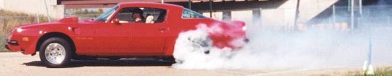

No decisions made. This thread is to explore possible combos, that might possibly be built to run the index or just slightly under, on a small budget, if such is possible. I think ya'll call 'em "dime rockets" ?
I have a '74 Ventura 2 bracket car now. It has a mild, iron head 455, TH400, 4.10 gears. Runs 7.30's 1/8 mile, footbrakin . But Bill Rink and another record holder got the hp factor up too high to use the '74 GTO body.

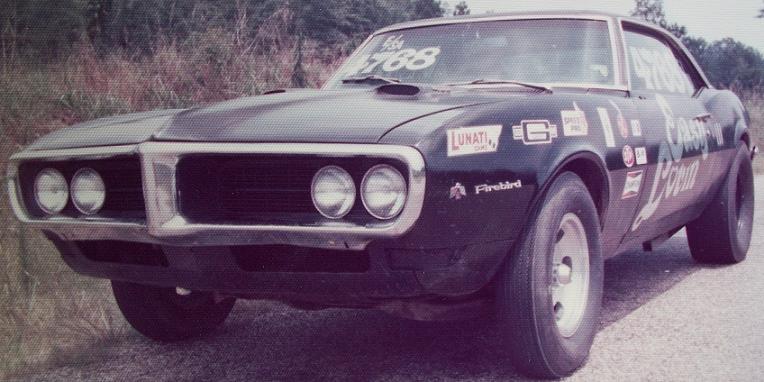

I also have a '68 bracket Bird under construction. It has a mild 455 with 6x heads, TH400, 9" converter, and 4.56 gears. Should run about a 7 flat 1/8 mile. I assume that would be a mid 11 sec 1/4 mile ET.
Now this motor would not be legal in a '68 Bird, except in GT/SS. But, a similar engine would work in '71-'76 Birds and A-bodies. To run the Bird in Stock, I'd need a 330hp 400. But Brent has already done a thread on his build with that combo. And I think the hp factor is too high on the 350HO in that model.

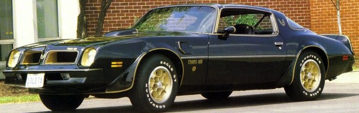

OK, lookin at it from a low budget standpoint, I need to make use of the parts I have, as much as possible. So, what I have the most of is 6x heads. They came on 350's 400's and according to NHRA even on some '76 455's.
So, using the 6x 455 that I already have built, I could run it in any of a long list of Pontiac bodies, from a TA in H/SA to a 5000 lb + wagon in Q/SA.
http://www.classracerinfo.com/Engine...px?ENGINE=2107
http://www.classracerinfo.com/NHRA_Classes.aspx
Now here's where the hp factors come in. The '75 455 had 5c heads, according to NHRA. Well, they are almost identical to the 6x heads. But the '75 455 is factored 10hp lower than the '76. I gather that you would have to carry aprox 100 lbs more weight, which would = about a tenth difference in ET. Is this correct ?
http://www.classracerinfo.com/Engine...px?ENGINE=2098
And in '75, according to classracerinfo.com the 455 was not available in the TA. And cars were real heavy back then. The lightest body I could use, weighed over 4000lbs.
The only advantages I can see to using a '76 TA body, besides the fact that they use 6x heads, is that they look a lot better and may be a little more aerodynamic than the '75 A-bodies, big cars and wagons. But is that worth the 10hp penalty ?
One advantage I can see for using one of the big cars is the purchase price of a good body. Most have been crushed long ago. But, if you can find one, they should be a lot cheaper than a good, '76 TA body.
So, for some of you guys who have played these hp factor and weight games, what do you see as the best option of all these '75 & '76 455 combos ?

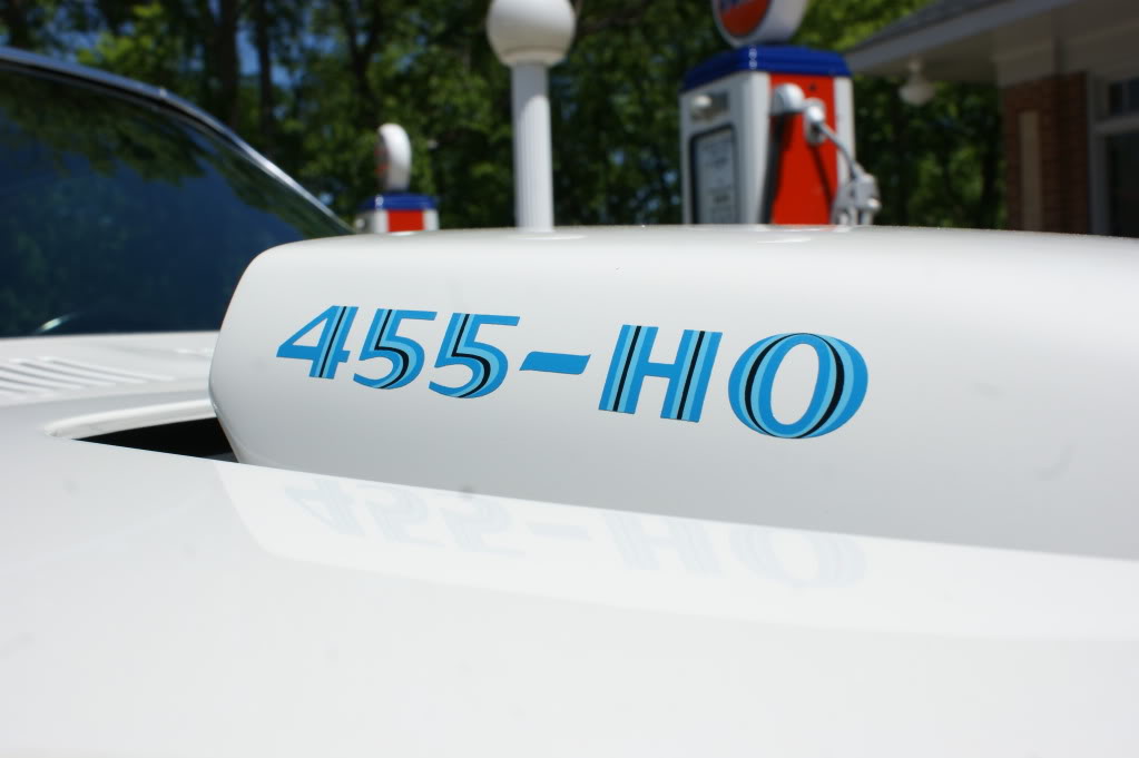

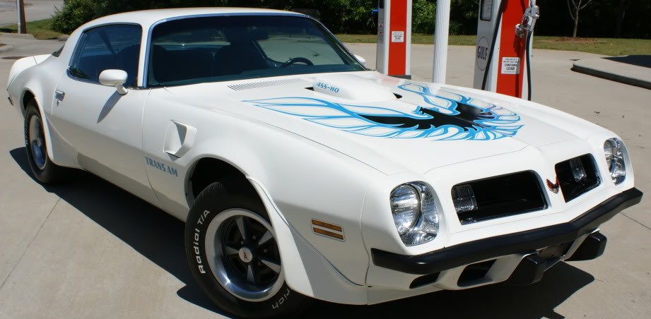

Now, here's something I found interesting. All the info I can find says that the 455 was available in late '75 TA's. I even found some pics of a restored 455 HO '75 TA.
Now they were HO in words only. There was absolutely nothing different in the TA engine and a 455 wagon engine. But anyhow, I wonder why the classracerinfo site doesn't show that it was indeed available in a '75 TA ?
