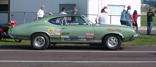

just to chime in ,,you would be hard pressed to run that # ,but there is a racer who runs a green 70-71 olds with a 4 speed set up (350 i think ) that could give you some insight on what you need to do with your car i dont have his info but he runs division 1 ,,if i can find the info i will repost gmonde

Isn't Bureski's W-30 in E/SA?

Mike Brogniez
Join Date: Jun 2009
Location: Montreal
Posts: 476
Likes: 7
Default Re: olds 442 w-30 stocker
Would it be S Murray.............
MB
