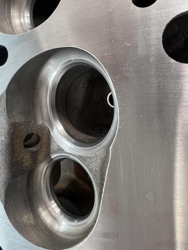

In the picture its hard to see but both the intake and exhaust valves are sunk quite a bit, probably to get CCs and piston to valve clearance, which I will check so I can get my heights setup before any work is done. Flow testing was done @ 28 inches, 4.350 bore, SF 600.

One thing to note, when a BBC head is flat milled to the extent this head is, flow is lost, although I understand CCs have to be met some way, it's definitely a juggling act. At this point I will clean the head, then locate the highest (closes to the piston) intake and exhaust valve and check piston to valve clearance then CC the chambers, after this the cylinder head restoration will start with pictures. If anyone has flow data for this type of casting in Stock Eliminator trim casting numbers, please feel free to post along with opinions.

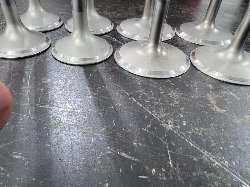

Great, happy to have you involved. More pictures

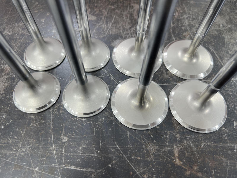

Exhaust flow is now:
.200 126 + 19
.300 160 + 29
.400 175 + 23
.480 178 + 13
Exhaust valve is tullipped.

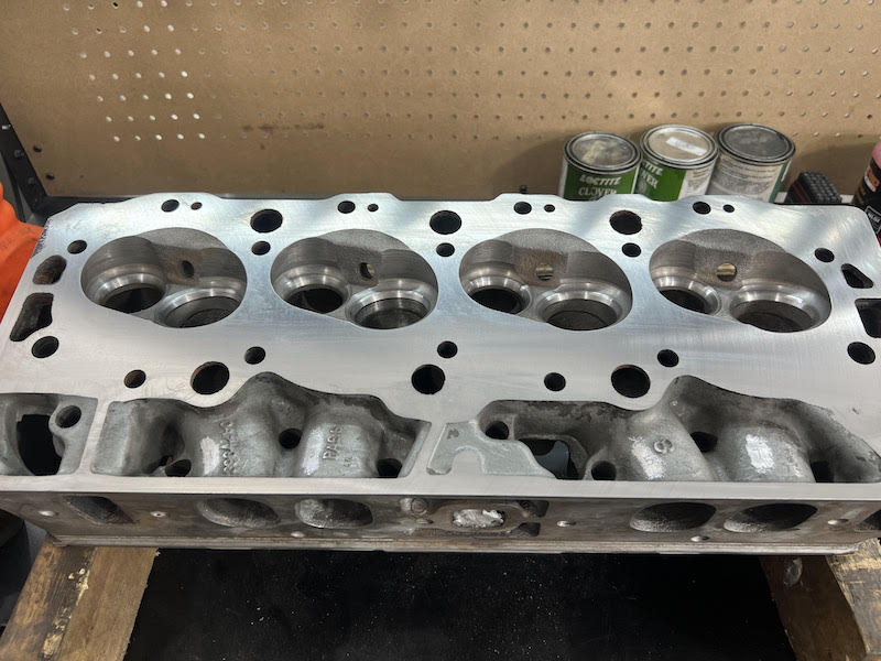

Ready to be cleaned and assembled.
