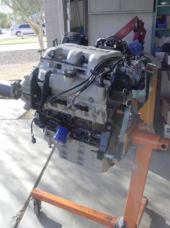

Anyway , this project is a DF/S car , and it did run 1.05 under the NHRA index on the second pass the other night...
A friend (who some of you might know) and I started on it in January.
Easy does it ...and I'll be glad to answer any inquiries about it if anyone cares to hear it.
I did take a few pictures along the way, but did not document every nut and bolt,..but I think I remember them...

Mark, how 'bout some basic info - Monte Carlo? Engine? year?
Mike Moller
NHRA 203 Q-R-T/SA
Old 05-25-2015, 09:56 PM   #3
Posts: 7,836
Likes: 2,928
Liked 5,147 Times in 1,964 Posts
Default Re: Dime Rocket- DNQ

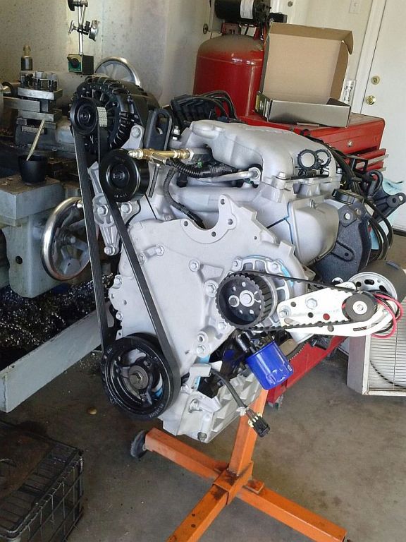

Okay..It's a 2003 3.4 60 degree Chevy V6 LA1 option (207 ci)
Not a totally original idea, but first in this body style and weight, I believe.
Before I forget..Blueprinted NHRA spec heads by Kadar Performance ..
PM me , or see Facebook

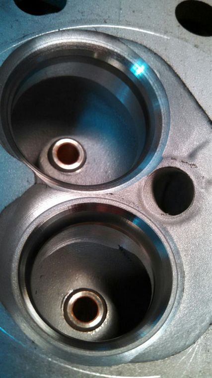

Ha. This thing is going in DF/S and staying there, once we get the weight installed where it belongs. (except maybe the IHRA 16.30 class ;-) ).
We have a family connection at Kadar Performance, so I don't know the pricing, but actually these heads needed to be straightened out anyway. Someone did a "valve job" on them last year,and carved them up pretty bad..Had to throw the valves away.
These heads are literally laying on the ground at the U pull it yards.
A little 3 angle , mill for cc's, and pop some new Comp beehive springs on them, and I don't believe they'd be too bad.
