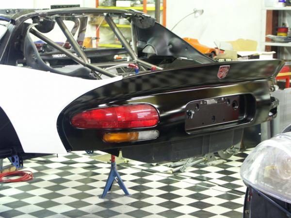

Assembly, Its quite handy to paint the whole body in sections and then just bolt or glue it in place :-)
http://classracer.com/classforum/pic...pictureid=7932
Mopar traditional semi flat black rear panel, I like it that way :-)
http://classracer.com/classforum/pic...pictureid=7933

http://classracer.com/classforum/pic...pictureid=7967
The Master Cylinder from Lamb on the narrow footwell.
http://classracer.com/classforum/pic...pictureid=7968
After everything was in place we found out we had a severe Bump Steer problem. We tried different solutions but ended up with moving the Steering Rack and fabrication of longer steer rods, so now it's acceptable. Any way the car isn't built for huge wheel stands.
http://classracer.com/classforum/pic...pictureid=7971
JP 08-29-2014 05:44 PM
Re: SS Viper
Looks like I'm not allowed to upload more pics, so the build story stops here.
Btw, 2nd test pass we did 9.39/147...
