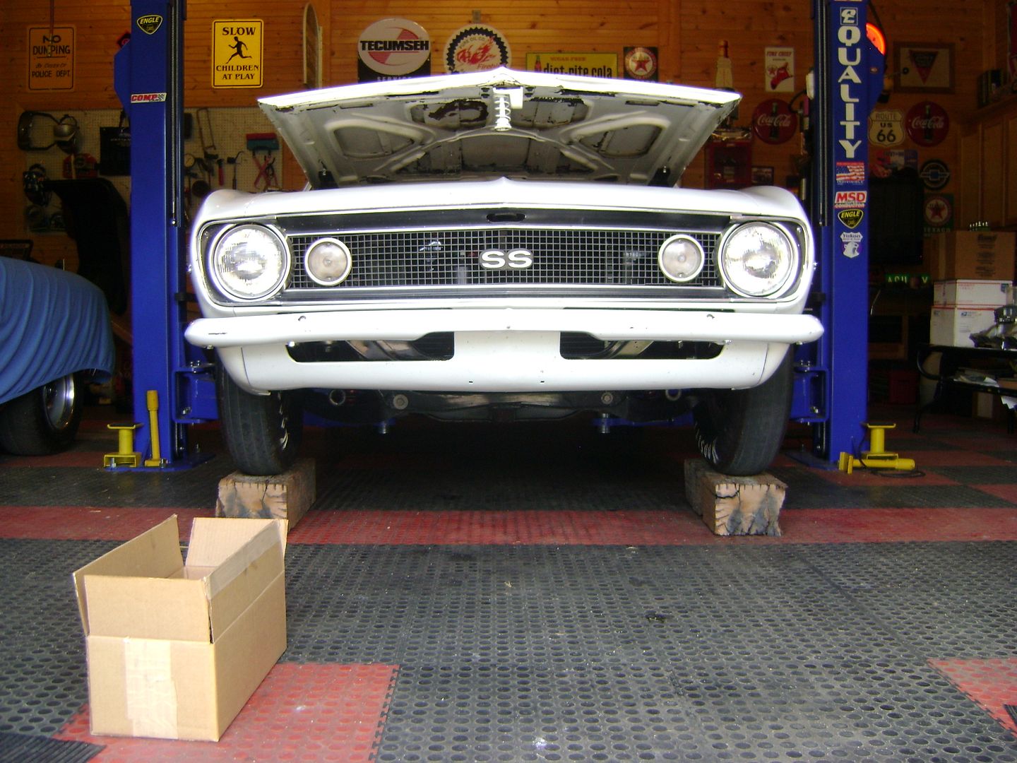

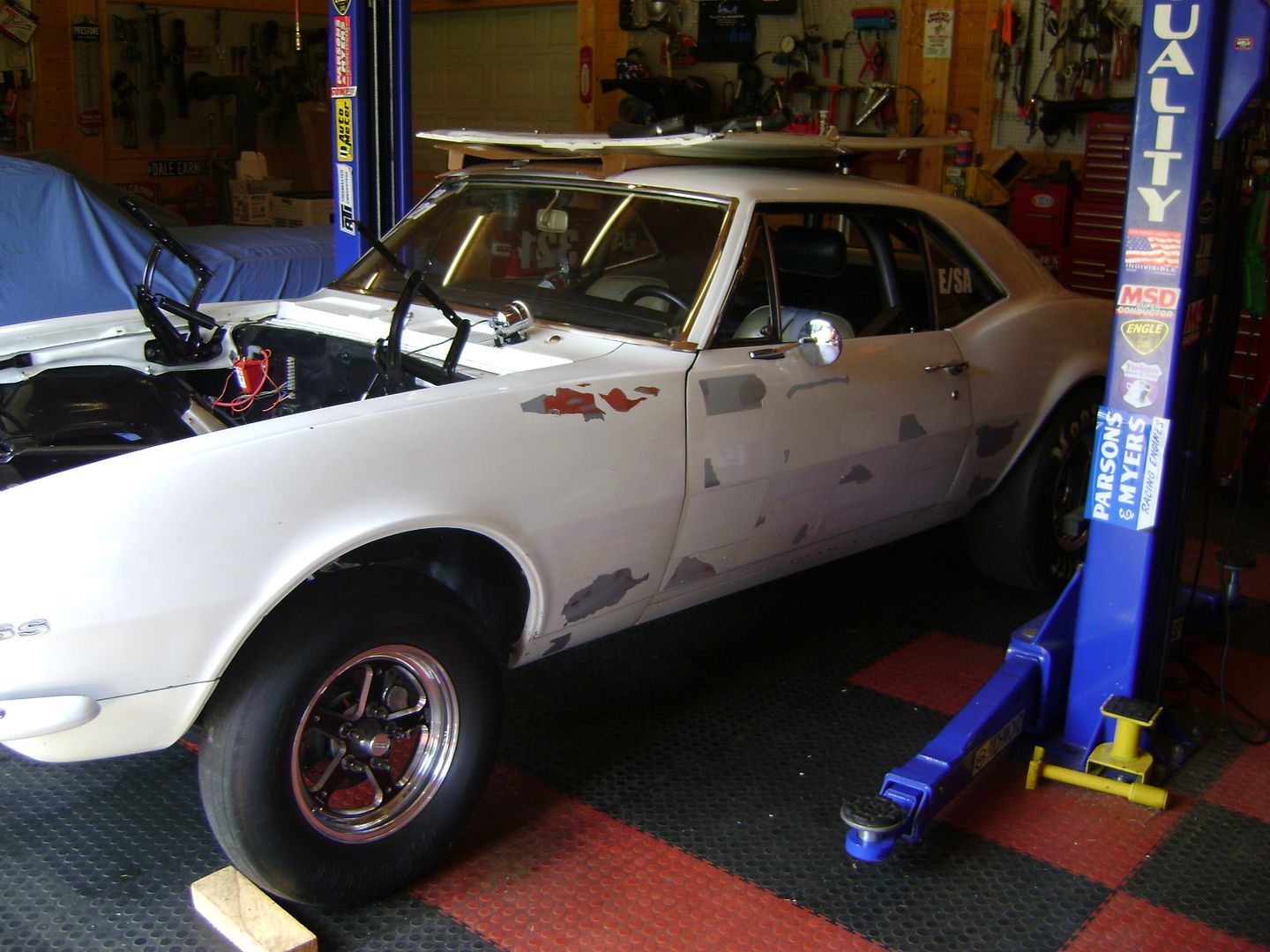

HandOverFist 07-09-2014 01:25 PM
Re: '67 Camaro E/SA redo
Making some minor changes before the Combo meet. The header collectors currently on the car may be a tad short and due to the megaphoned style made it difficult to use extensions...
http://i434.photobucket.com/albums/q...psc7790432.jpg
I'm going to swap them out for a straight version and play with the length. Will also hook up the wide band O2 I have been meaning to try...
http://i434.photobucket.com/albums/q...psbdde62ff.jpg

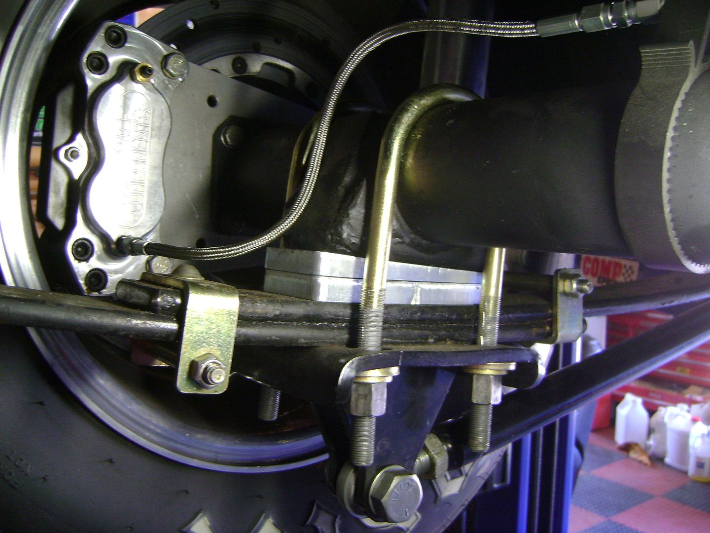

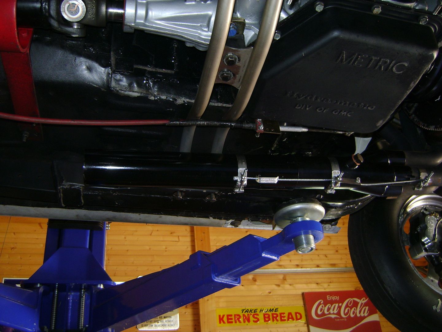

Came up with the idea of cutting one of the lowering blocks on each side of the rear housing to simulate the previously used 2 degree pinion wedges. I think the car liked the extra pinion angle and this will get the job done without having an extra piece floating around in the mix while ensuring positive pin engagement.
tommy d 07-10-2014 05:10 AM
Dig the "MARVY" barber pole! I've had a few over the years.
brent flynn 07-10-2014 11:37 PM
Keep us posted.. hope you have a good weekend...
Im gettin ready for Columbus... probably goin in at .3 to .35 under ,, but, i dont care...hehe half the fun is gettin there, right?
HandOverFist 07-12-2014 12:13 AM
Here is a shot of the lowering blocks I had machined for a 2 degree wedge...sitting at 4 degrees pinion angle now.
http://i434.photobucket.com/albums/q...psd3b3ad1c.jpg
Before and after shots of the collector/extensions...
http://i434.photobucket.com/albums/q...psa0408dc4.jpg
http://i434.photobucket.com/albums/q...ps95d2defb.jpg
Finally rounded up some blocks so I could more easily slip under the car to take measurements. Next set of slicks will be 94" in place of the current 92.5".
http://i434.photobucket.com/albums/q...ps6f2e9e74.jpg
http://i434.photobucket.com/albums/q...psde226269.jpg

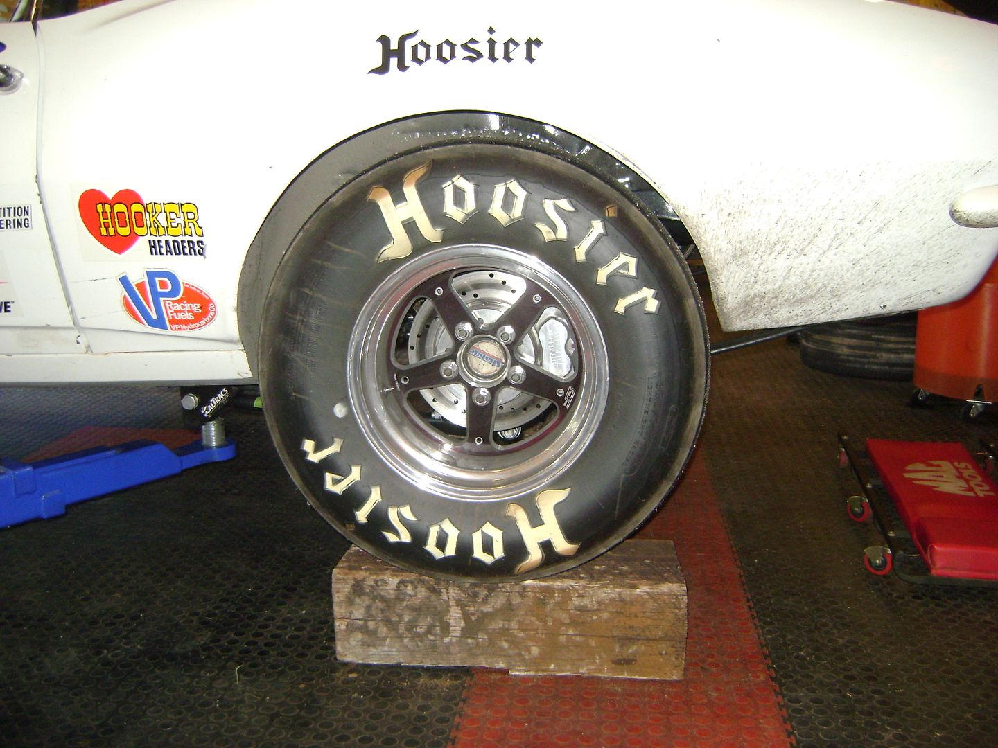

HandOverFist 07-13-2014 08:15 AM
Originally Posted by brent flynn (Post 437740)
Most people say that the 92.5 is the faster tire....why you wanna go with 94"? Gearing? Im probably goin with a 92.5, so i can gain some clearance, and worse case, i go back the 4.30 gear... are your 92.5 tires about worn out? I would like to pick up a good used set, to try on the car...
When I cut the blocks it raised the rear a bit as you can see in the pic's. It is buzzing the motor pretty good now with the 5.14 gear and 92.5 tires...figure I can accomplish two goals at once with the tire change. Current tires are fresh so it will likely be next season before the swap. I do have the previous set which have only around 50 passes on them if you would like to try.
Before block cut -
http://i434.photobucket.com/albums/q...ps6f1dceac.jpg
After -

HandOverFist 07-14-2014 10:42 AM
Originally Posted by Monte Howard (Post 437777)
You will slow that car down with 94" radials. Been there and done it. With the same combo.
Do you think that was due to the change in overall ratio or tire weight? Hoosier shows the same weight (22lbs) for both tires. What was the difference with your combo?
http://www.hoosiertire.com/Drtire.htm

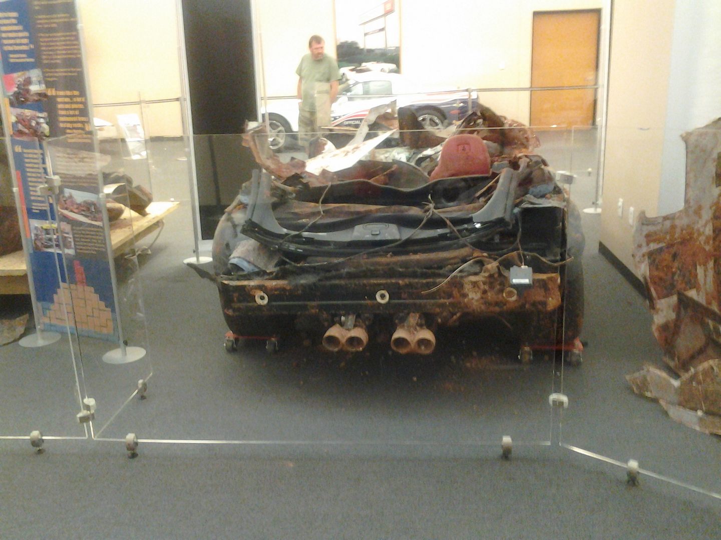

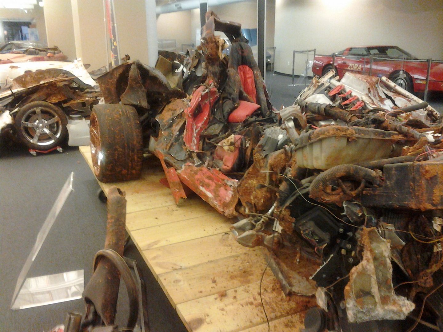

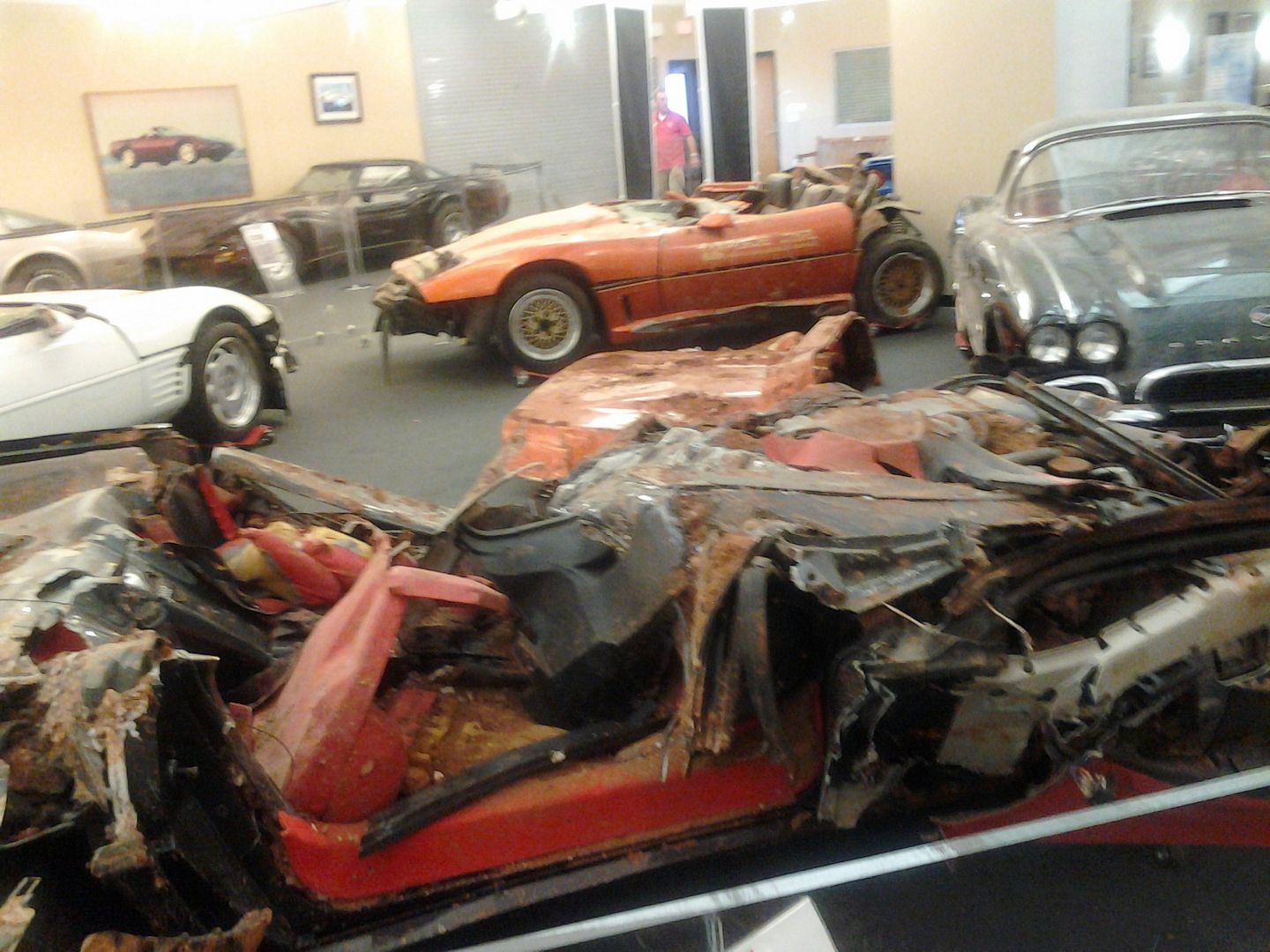

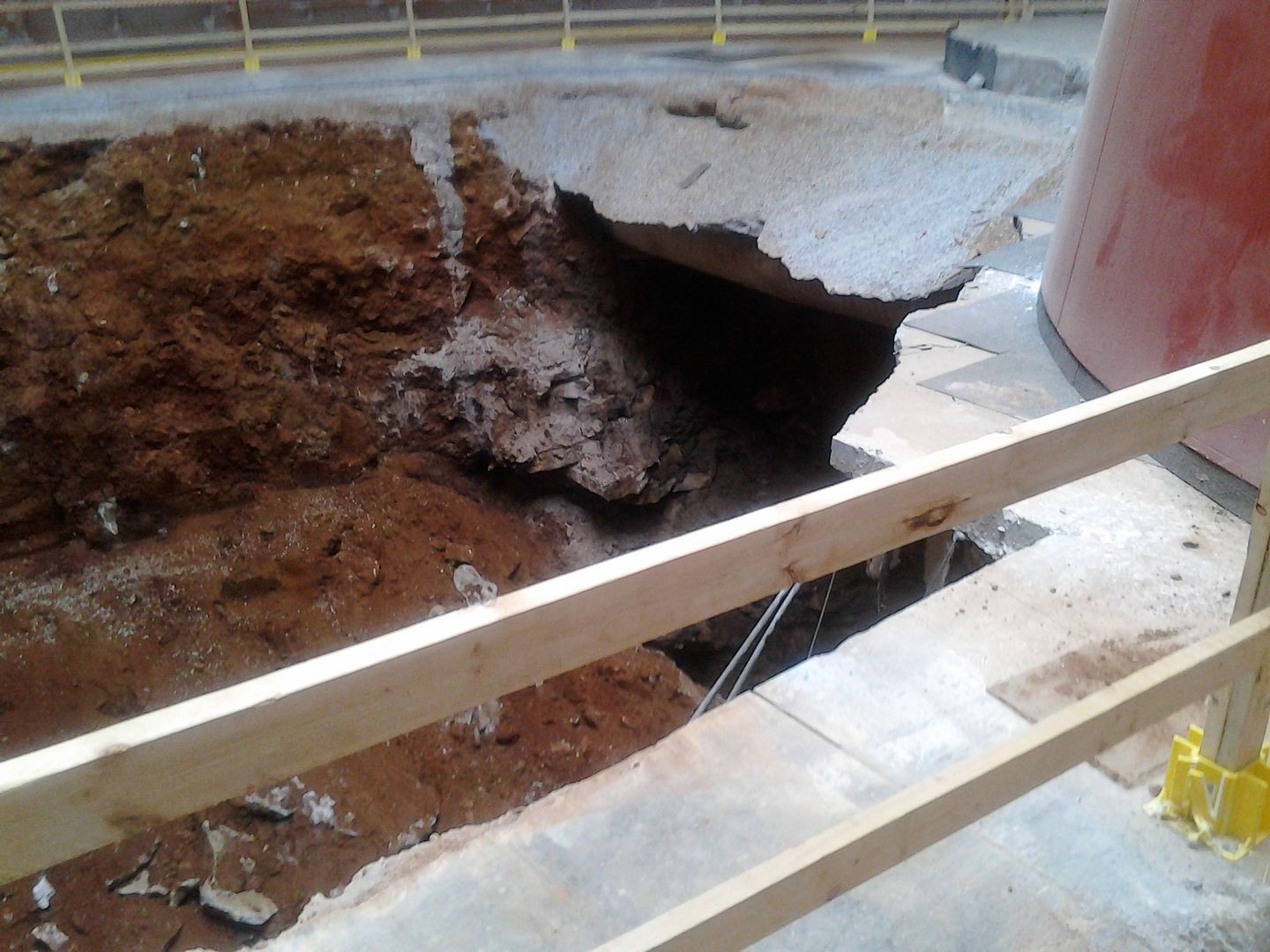

HandOverFist 07-20-2014 10:21 PM
The two day Combo meet at Bowling Green this Saturday and Sunday was cut short by one day due to rain. Sunday brought fair weather and the meet went on as planned.
We had some time to kill early Sunday morning before leaving for the track so my partner and I decided to go check out the Corvette Museum since neither of us had ever set foot in the door.
Partner hard at work as usual...
http://i434.photobucket.com/albums/q...pse9562c5b.jpg
I did not have a camera with me so I used the cell phone for the first time in my life...please excuse the quality. It was hard to believe the damage incurred to those cars from the sinkhole...I don't think a car crusher could have done as much damage. Only four cars were salvageable, the rest being totaled. From what I understand the wrecks are to be put back into the hole.
http://i434.photobucket.com/albums/q...ps913b3554.jpg
http://i434.photobucket.com/albums/q...psac1dc91b.jpg
http://i434.photobucket.com/albums/q...ps737861d6.jpg
http://i434.photobucket.com/albums/q...ps34ea98ac.jpg
http://i434.photobucket.com/albums/q...ps944bc726.jpg
http://i434.photobucket.com/albums/q...ps6475271a.jpg
http://i434.photobucket.com/albums/q...ps6f86aa07.jpg
http://i434.photobucket.com/albums/q...ps73f0d50e.jpg
http://i434.photobucket.com/albums/q...ps0b5cd7f3.jpg
HandOverFist 07-20-2014 10:25 PM
More...
http://i434.photobucket.com/albums/q...ps90d2810e.jpg
http://i434.photobucket.com/albums/q...psb6868d87.jpg

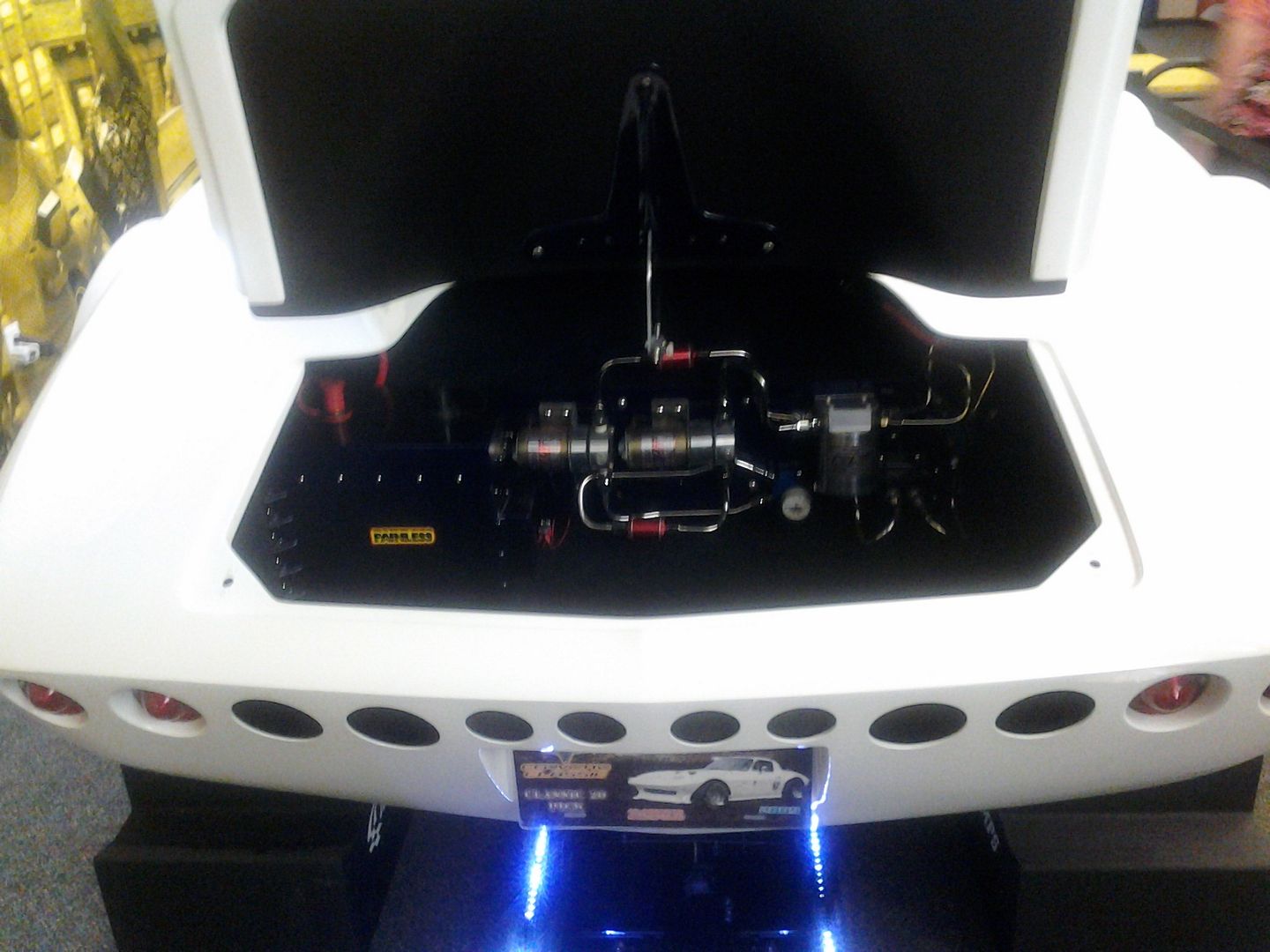

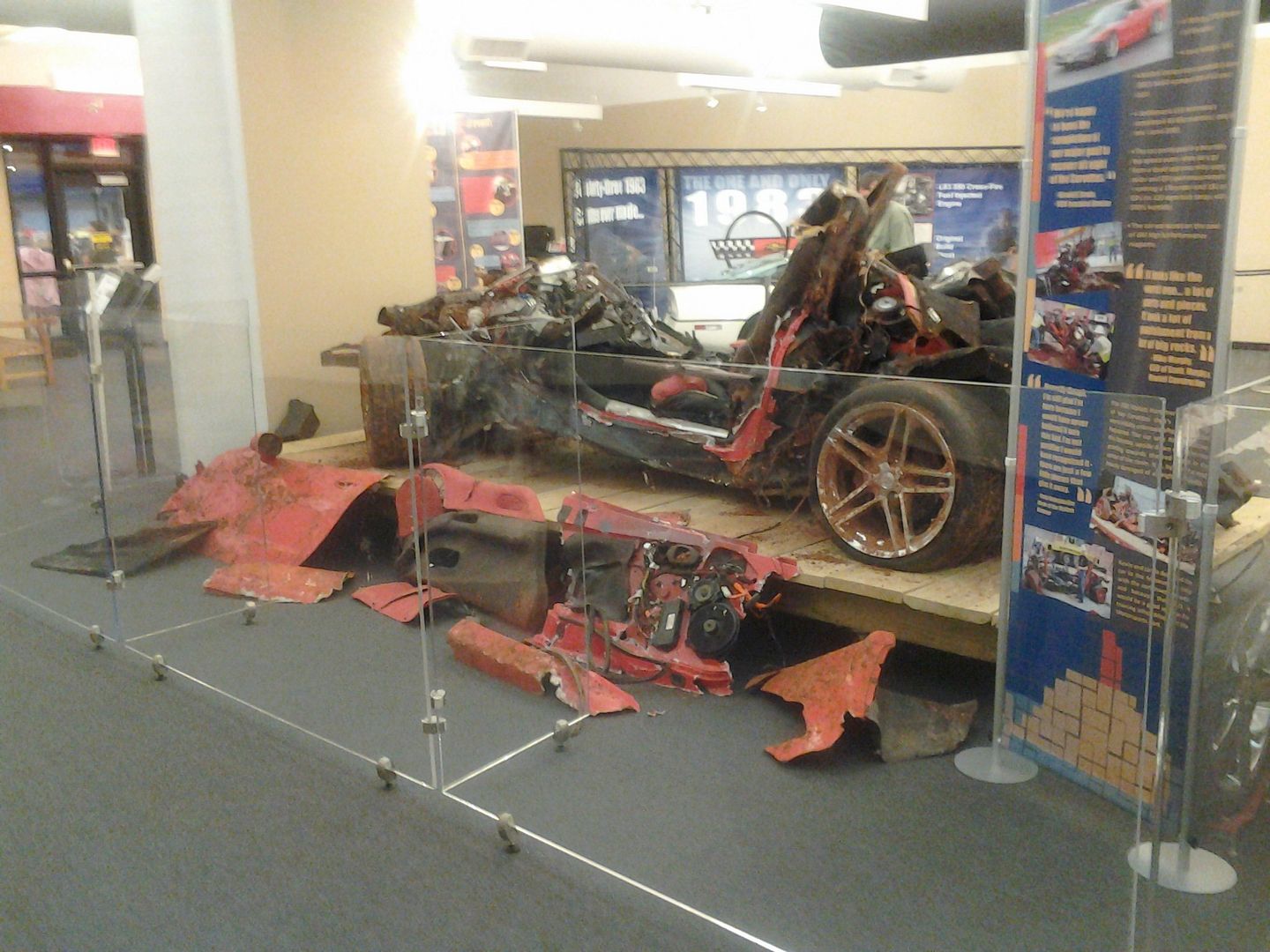

HandOverFist 07-20-2014 10:31 PM

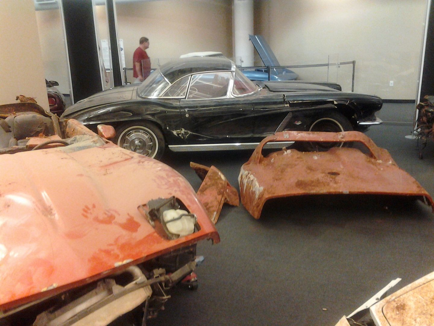

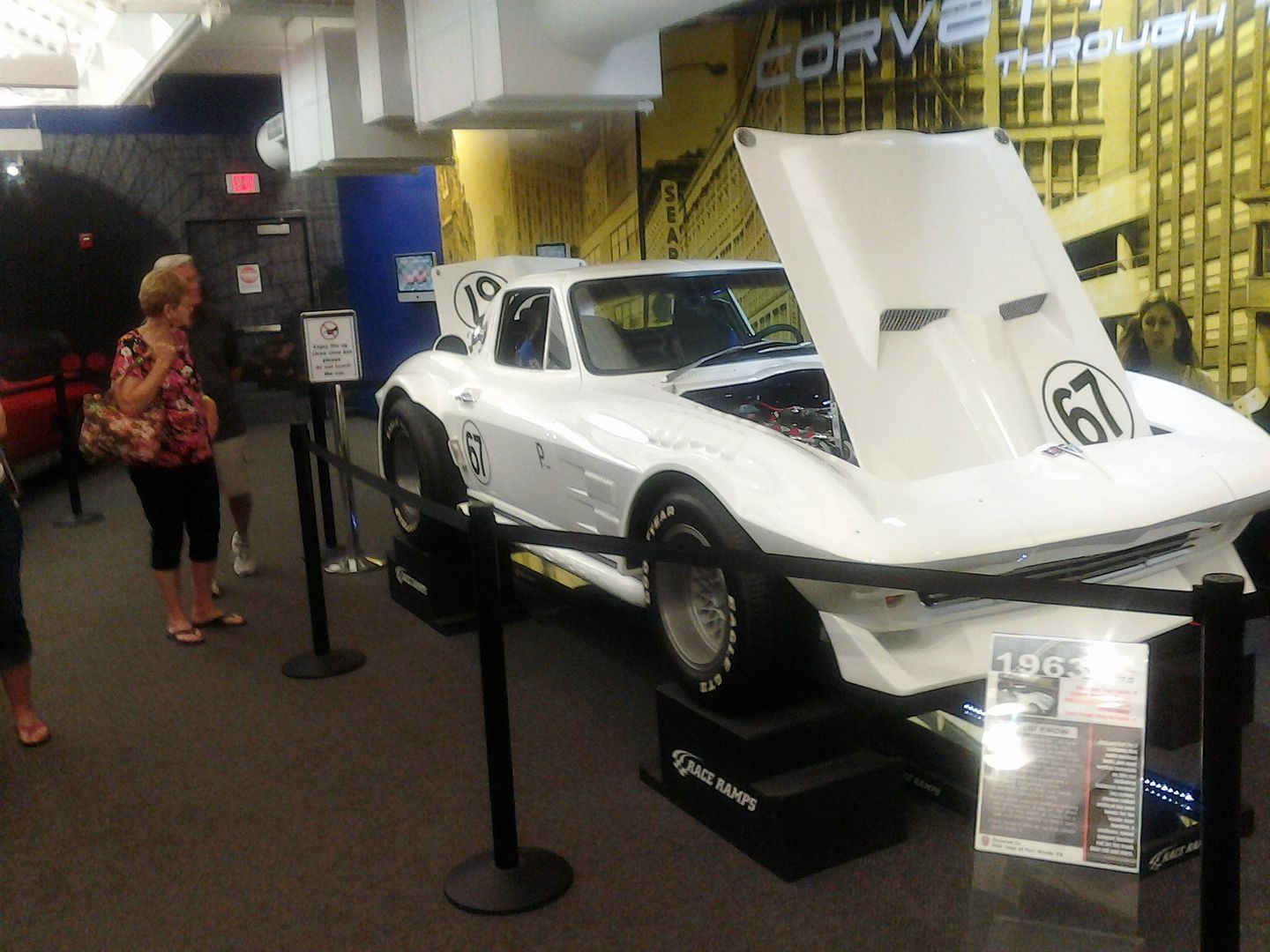

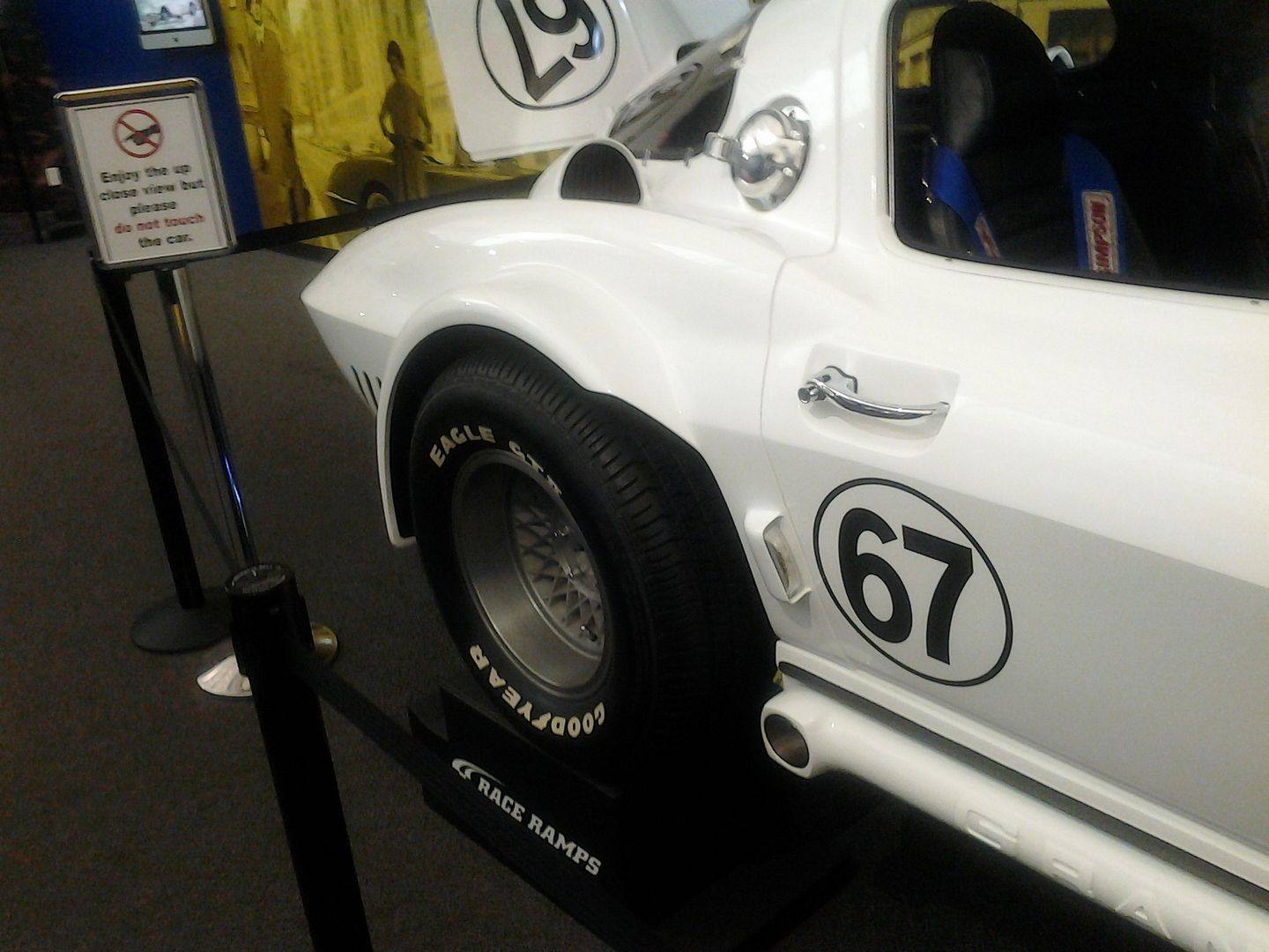

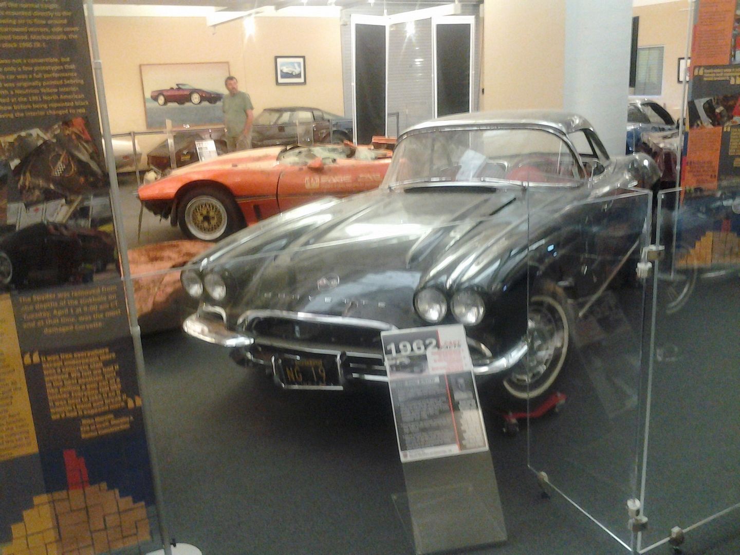

Hands down the coolest Corvette I have ever seen...wish I had better pictures.
http://i434.photobucket.com/albums/q...psb6273e87.jpg
http://i434.photobucket.com/albums/q...ps1d4e4d10.jpg
http://i434.photobucket.com/albums/q...ps8b4386ca.jpg
http://i434.photobucket.com/albums/q...psfb8cd9de.jpg

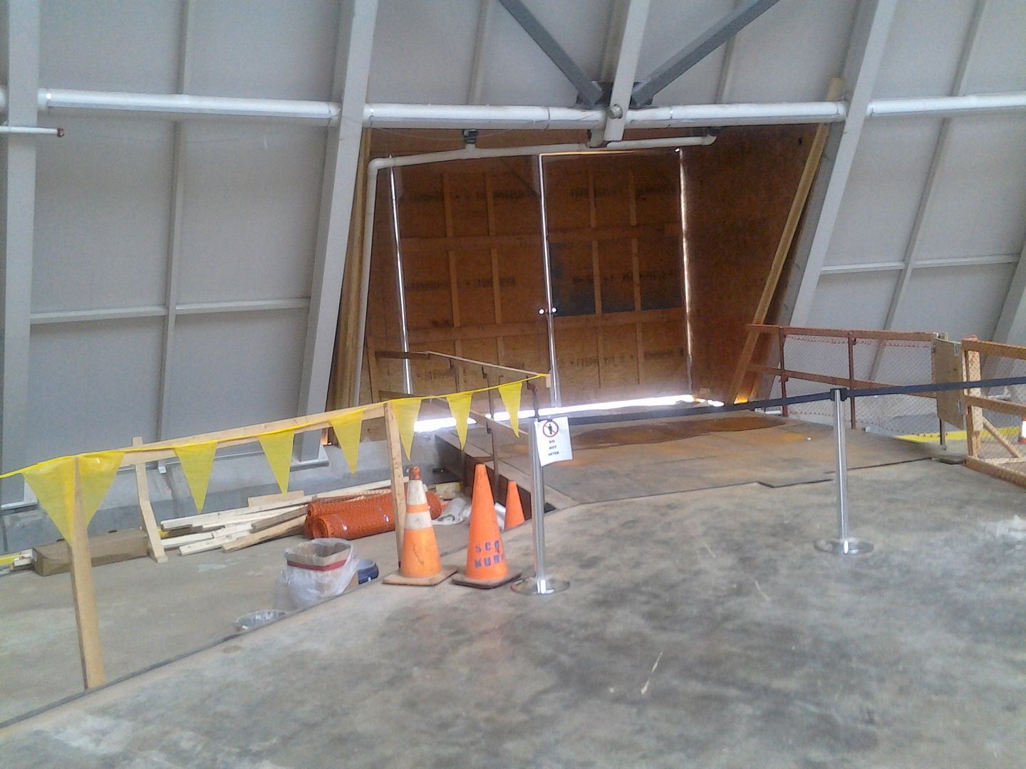

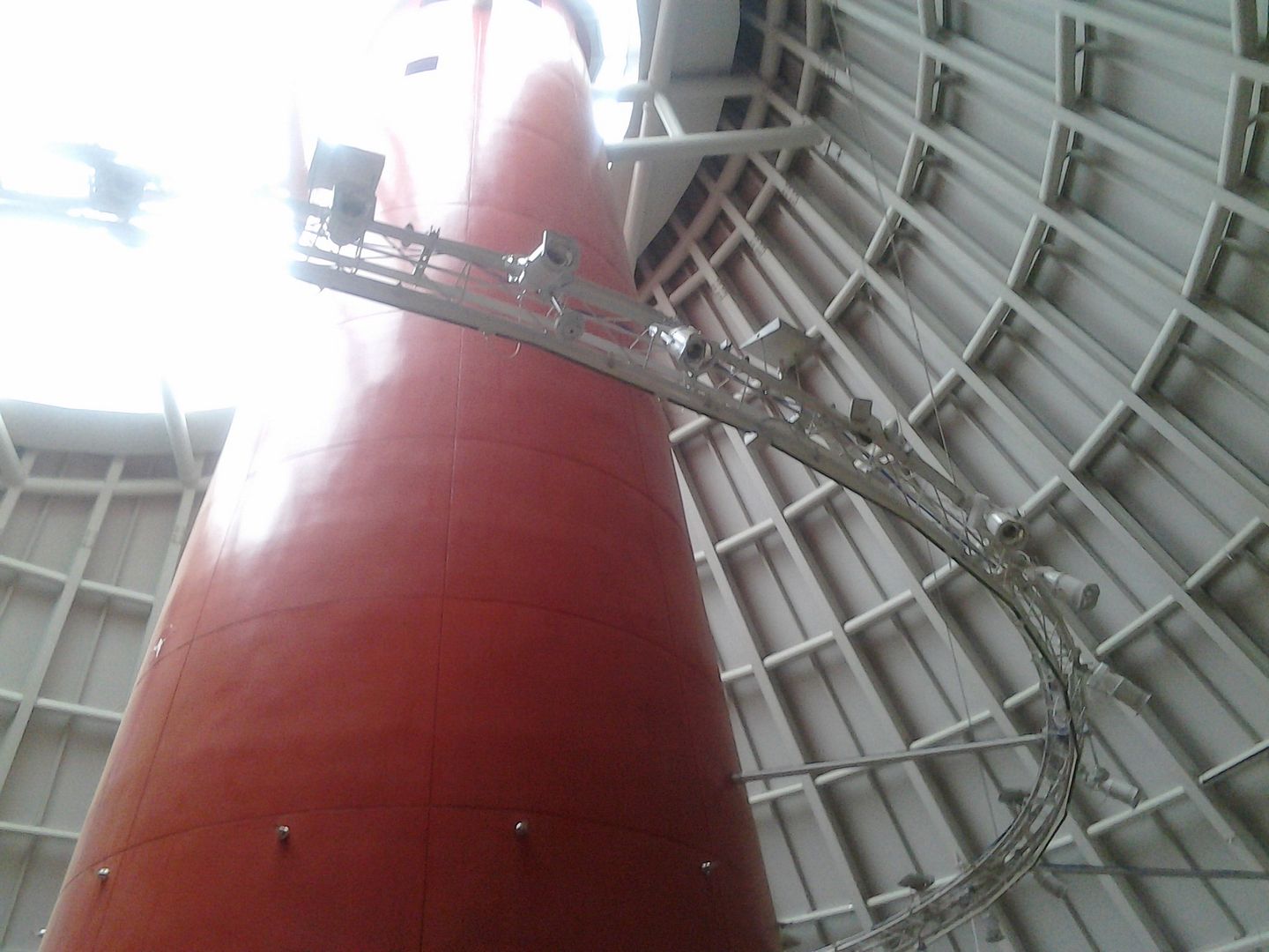

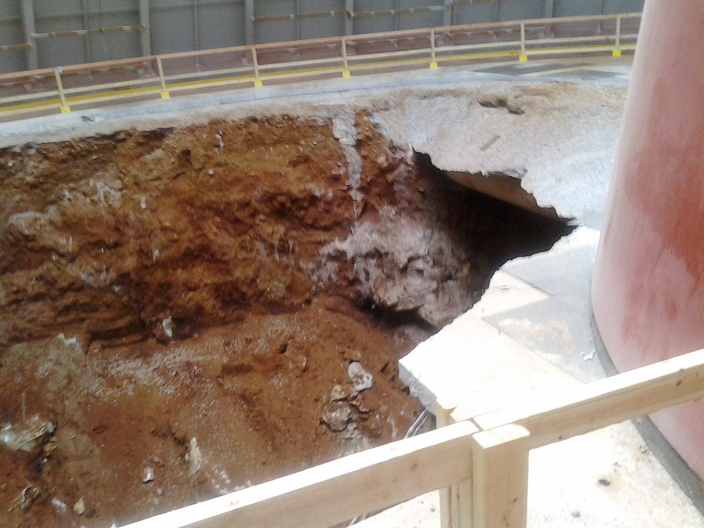

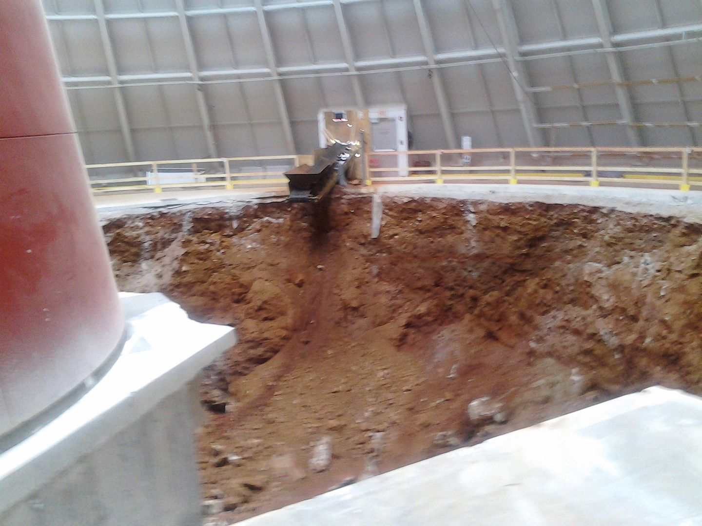

Best pictures I could manage of the sinkhole...
http://i434.photobucket.com/albums/q...psaa583d5b.jpg
http://i434.photobucket.com/albums/q...ps362c702c.jpg
http://i434.photobucket.com/albums/q...ps121d112c.jpg
Hatch where the cranes came in...
http://i434.photobucket.com/albums/q...ps3988ee17.jpg
http://i434.photobucket.com/albums/q...pse8563d25.jpg

Ronnie Smith Jr 07-21-2014 08:13 PM

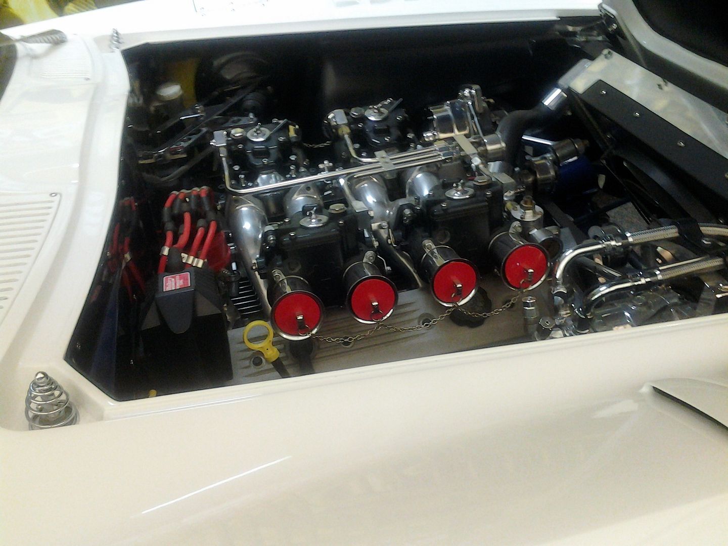

On our journey from Lexington to Nashville a couple of weeks ago from and to a basketball tourney, we stopped by the Corvette Museum. What a spectacle! I agree, I don't think a car crusher could do any worse damage to the 4 totaled Vettes. Otherwise, a great tour stop. My first time there.
Thanks for posting the pics.

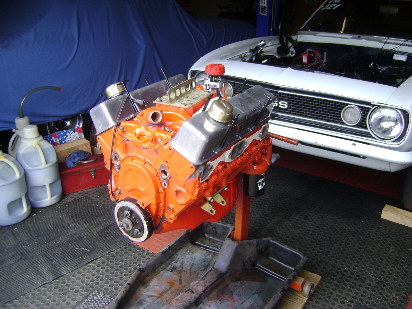

HandOverFist 07-27-2014 01:47 PM
Hated to do it at this point in the year, but something has to be done to find some hp. I'm going to try to reuse the stock block if possible this go round...efforts will be centered mainly on internal drag and windage, then on to the heads, intake and cam.
http://i434.photobucket.com/albums/q...ps127980db.jpg
Ambitious as usual I stripped the decals off the body (along with some of the paint) in preparation for some new paint.
http://i434.photobucket.com/albums/q...ps0e2de2a7.jpg
Alan Nyhus 07-28-2014 10:29 PM
Rich, I sure hope you put the white back on it. '70 Corvette Classic White has to be the best race car white, ever. -Al
HandOverFist 07-28-2014 11:28 PM
I agree Alan, but my partner wants something with some color to it. I'm leaning toward Sierra Fawn...only 2% of these cars were sold with that color and I have yet to see one on the track. http://www.69pace.com/paint1967sierrafawn.htm
theman440 07-28-2014 11:32 PM
I vote Fawn - different is better. IMO
