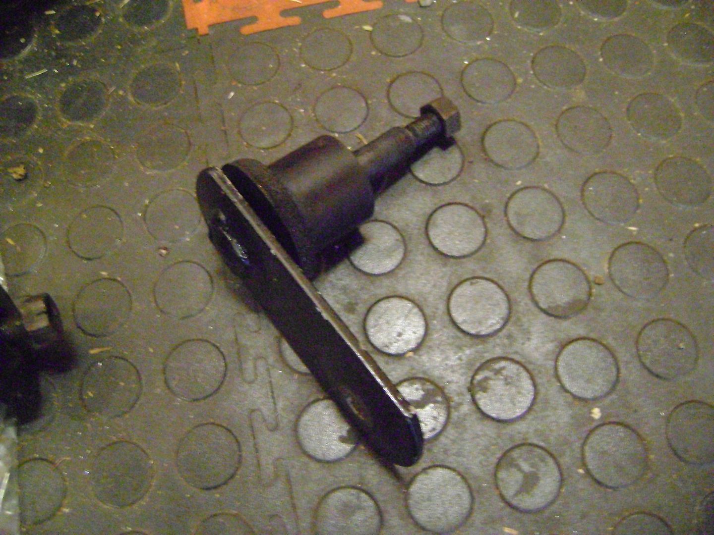

Stock replacement. I bought the global west bushing....one fell in and the other was .050 to big. So i sold them to a friend and my mission is to build a set once my lathe is hooked up. Global West did say they would build me a set but after seeing what they sent its a simple project for anyone with some basic machine shop experience.
HandOverFist 04-29-2014 09:50 AM
Re: '67 Camaro E/SA redo
I wouldnt put much effort in it...anything that fits the holes will be fine. The only thing that moves on mine are the thick side plates. I used slightly longer bolts and nyloc nuts to secure but not tighten the plates against the bushings...swings freely.
CrateCamaro 04-29-2014 09:50 AM
FYI the solid rear shackle bushing are a good idea they will stop any lateral movement and operate super smooth. Im constantly looking for a grease that will live and not move away from the bushing. I service the spings once every 3 races just to make sure that shackle is moving free and not bound up. I just had it all appart and tried ARP fastener lube on it. I was able to tighten the bolts all the way and the shackle still moved smooth. After a few hits at the track we will see if its still happy.
CrateCamaro 04-29-2014 09:52 AM
I agree. I use old 3/8 polly locks on the top and a jam nut on the bottom with factory replacement shackles and bolts...LOL. works fine i think
HandOverFist 04-29-2014 09:55 AM

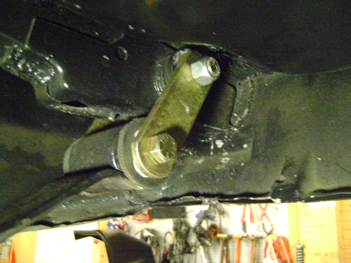

My way I don't have to worry with grease at all. Not to concerned with a little slop as this car only goes in a straight line...I hope hehe. :p I think those using a factory side plate with the welded thru bolt have more issues. Mine are seperate plates and bolts.
http://i434.photobucket.com/albums/q...ps1f54e319.jpg
Factory parts...
http://i434.photobucket.com/albums/q...ps5985ed8c.jpg

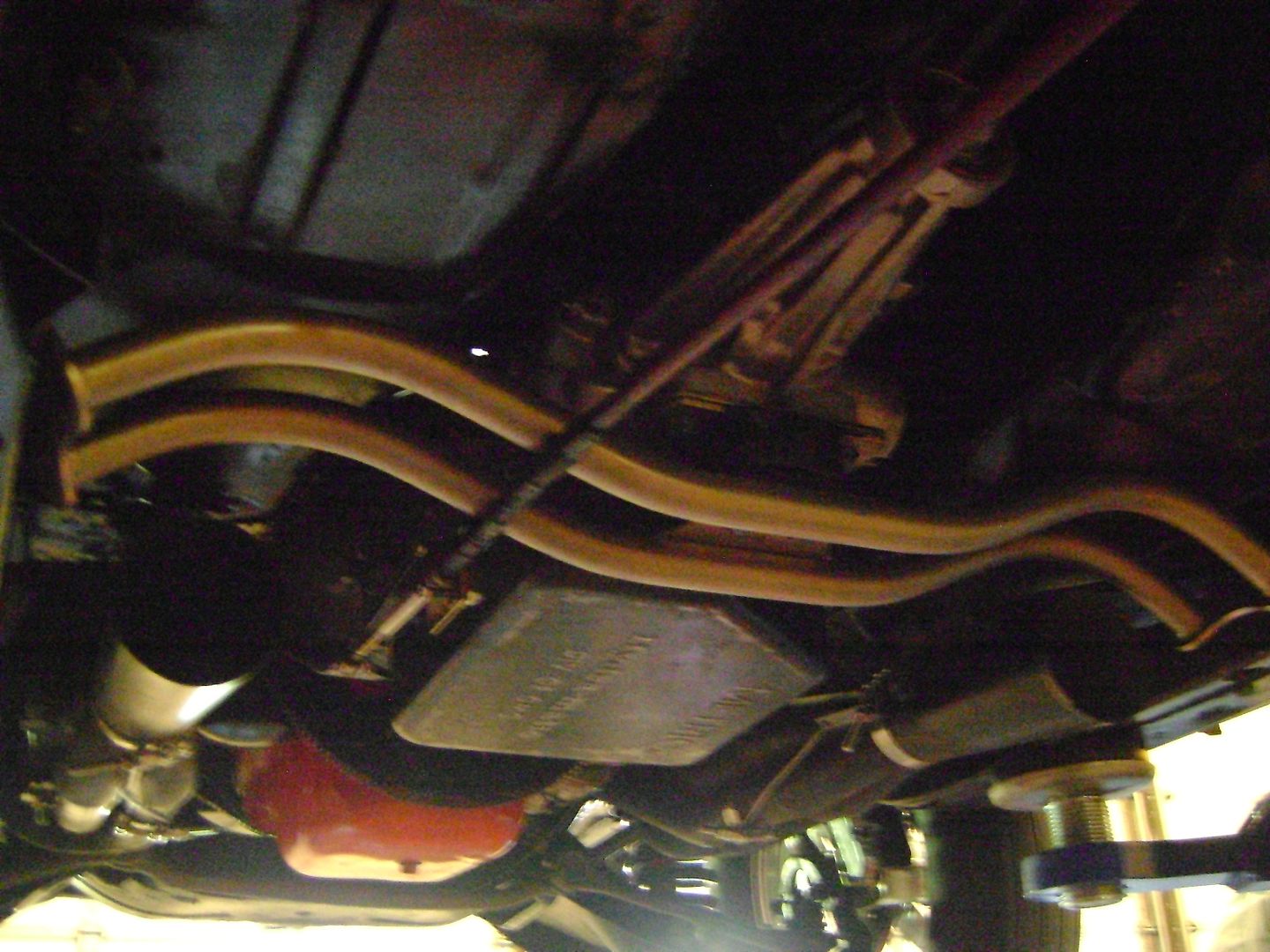

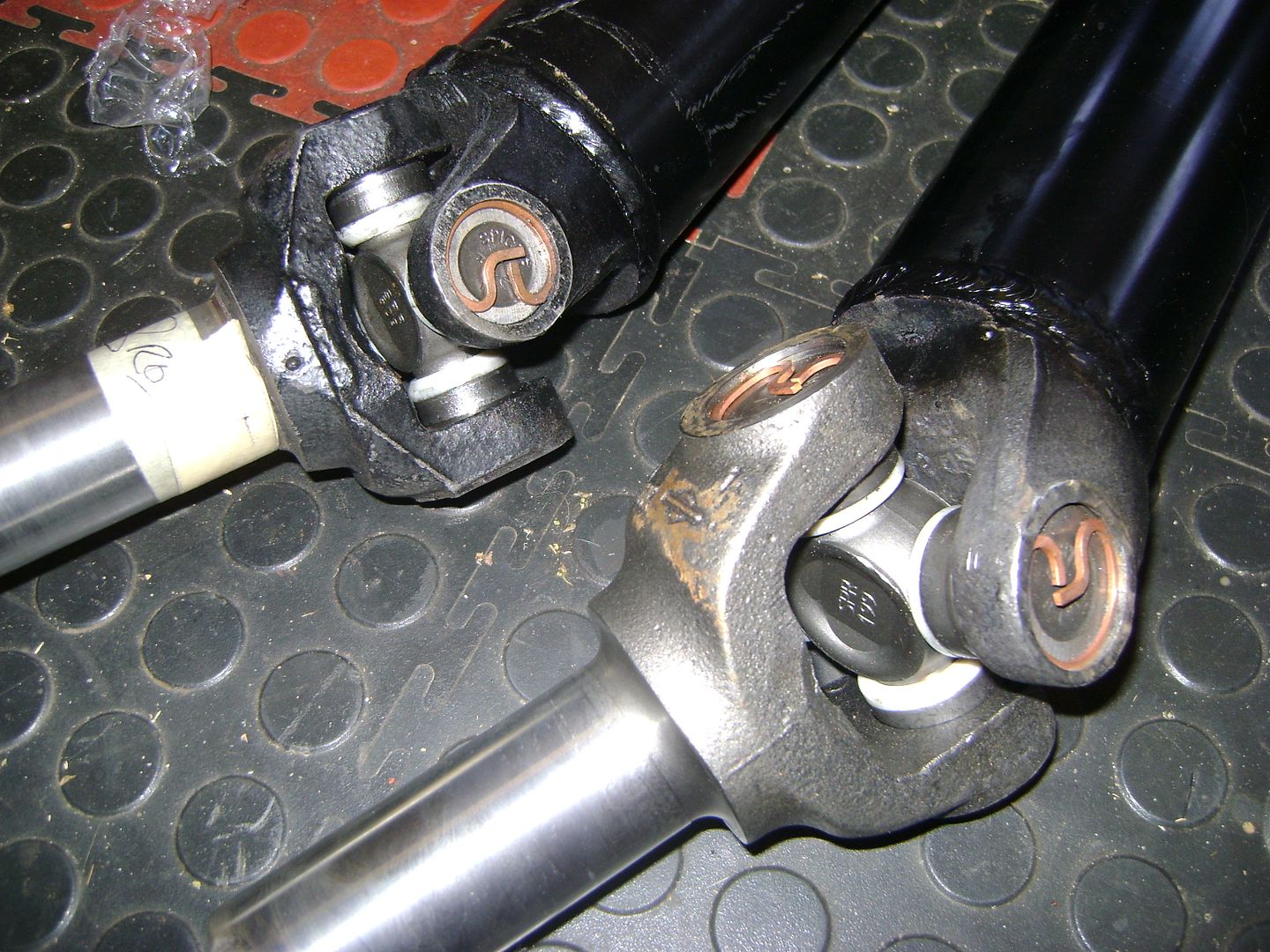

Side by side comparison of a 1310 joint vs a 1350...
http://i434.photobucket.com/albums/q...psaf74cdd6.jpg
Crossmember installed...
http://i434.photobucket.com/albums/q...ps9b0b01e3.jpg

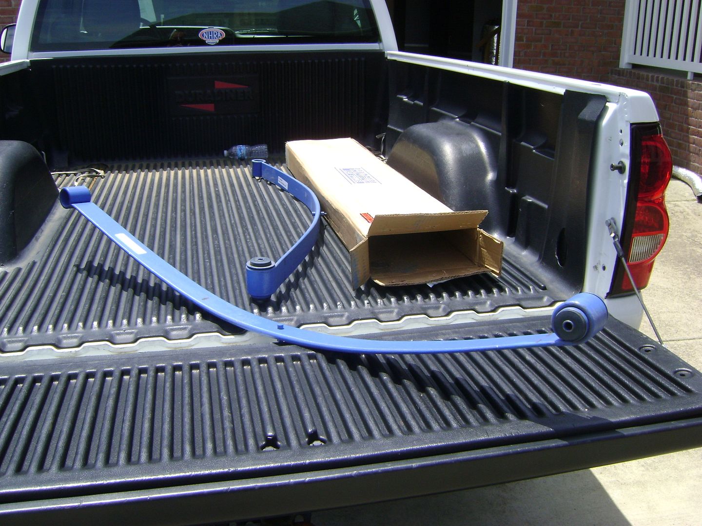

Landrum 150# monos...hope these are the last say.
http://i434.photobucket.com/albums/q...pse640d465.jpg
Robert Simpson 05-02-2014 02:55 PM
Rich,
Did you have any problem installing the cross member and did it seal lighter or heavier than the stock one? Thanks
HandOverFist 05-02-2014 09:38 PM
New crossmember slipped right in...it is lighter being tubular, but the shift cable interference was not improved. I ended up adding some spacers between the shift cable bracket and the pan. The end of the cable that connects to the shift arm is at a slight angle...best I can do with it for now.
I ended up swapping springs this evening instead of going to the track with the stock mono's. I felt like the housing might try to move without a locating pin on both sides of the leaf. The 150# Landrums feel just a tad stiffer than the stockers, but still good. I'm guessing the stock leafs are rated around 125#. I did have to use one lowering block to get the ride height down...it's just a little higher atm and it may settle a little after some use. Will try to get to a track tm evening to try it out.

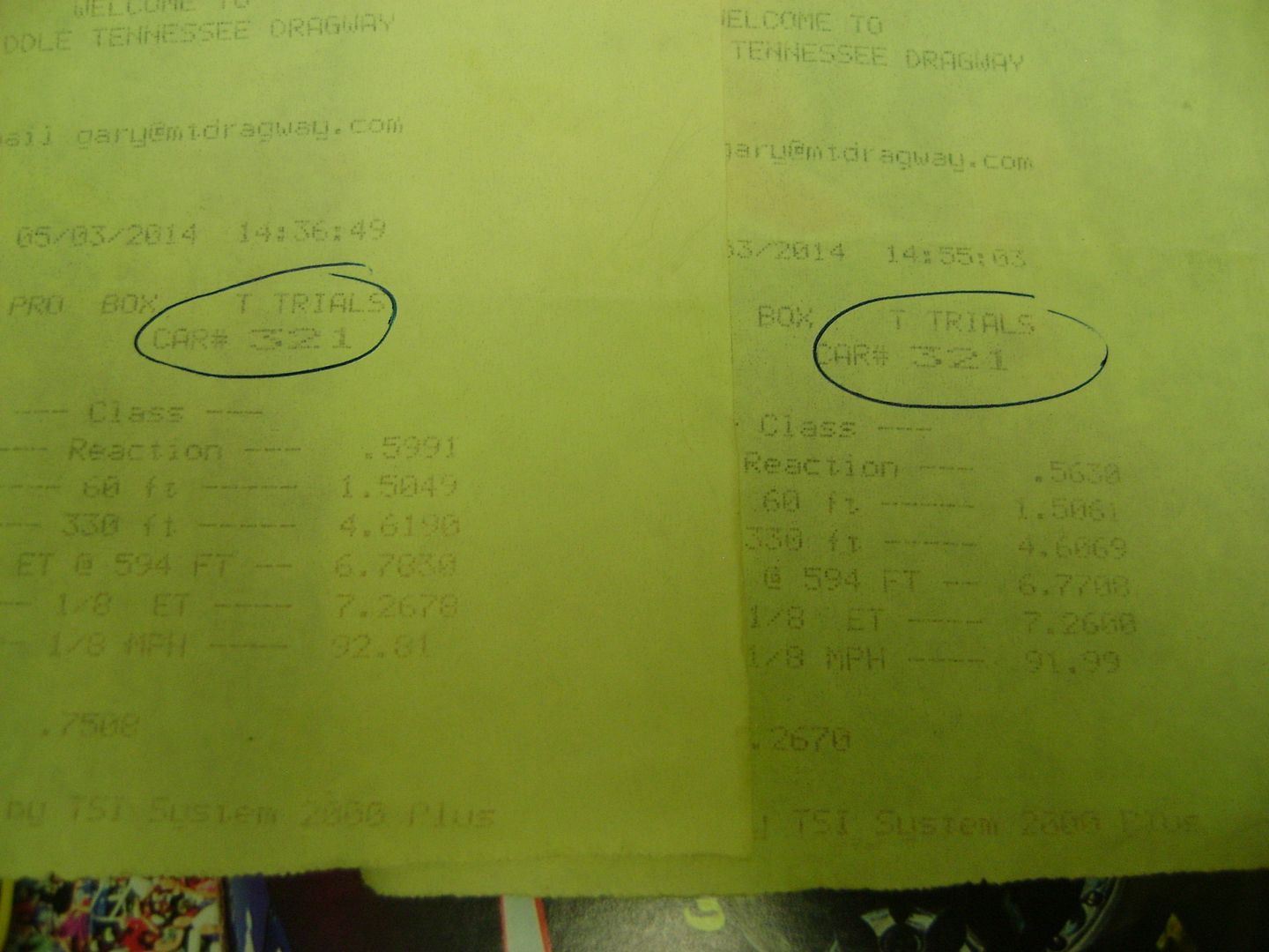

Went to the track today hoping for some good results...a mixed bag at best. The good news is I did not break anything and I did not require the use of the winch to load the car hehe.
The car repeatedly shucked out 1.50 60' times and ran 7.26's back to back. The car is leaving like the old Mopar's used to...straight out with barely any front-end upward motion. I believe I am now battling some type of carb issue as it just doesnt hit the tires hard like it once did. Don't believe it has anything to do with the spring or shock changes. The GoPro video shows nothing of real interest that I can pick out.

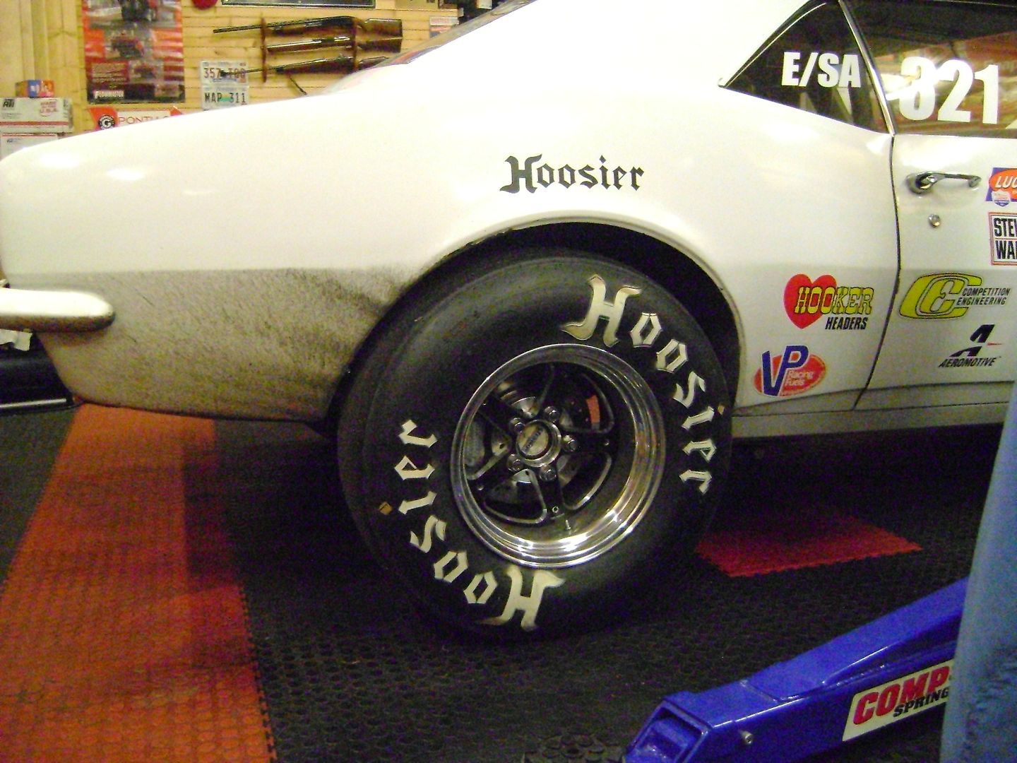

With only one lowering block installed the ride height is slightly higher than previous...figured I would let it ride for a bit to see if the new springs settle any.
http://i434.photobucket.com/albums/q...pse770c223.jpg
http://i434.photobucket.com/albums/q...psd79298a6.jpg

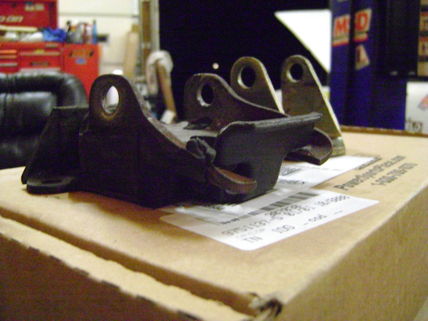

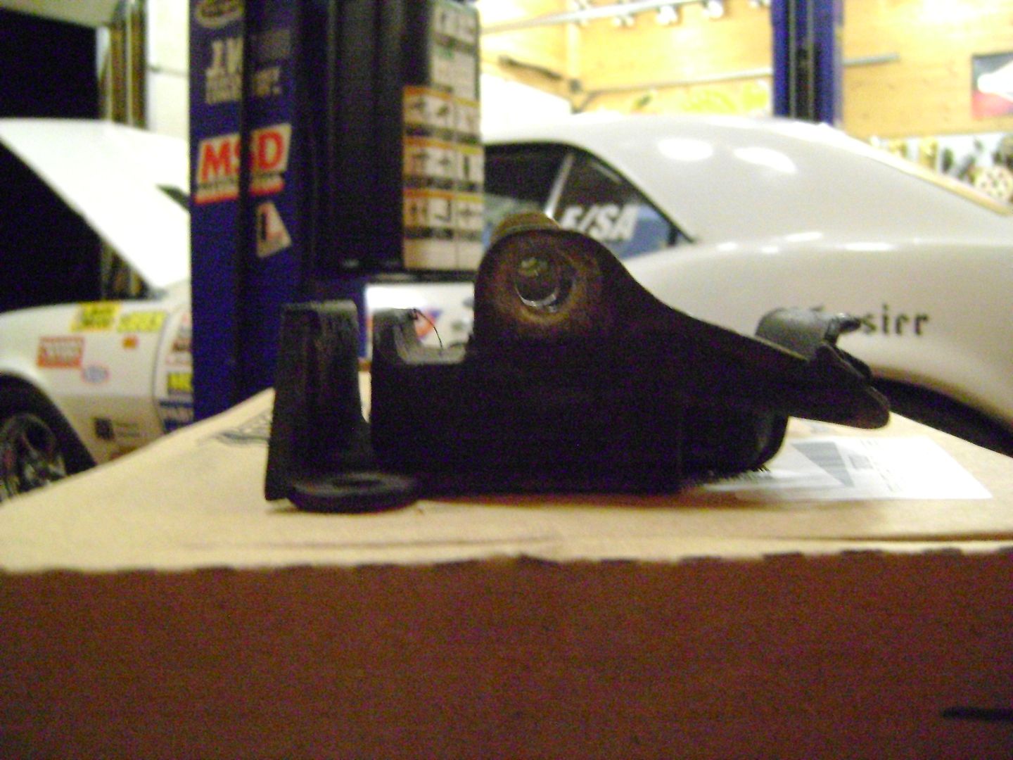

Here are the old motor mounts I pulled out of the car. There was almost a 1/2" difference in height between the two...likely the culprit for the cracked cases.
http://i434.photobucket.com/albums/q...psab761f10.jpg
http://i434.photobucket.com/albums/q...ps38cc829a.jpg
I will keep at it until I find the bug.

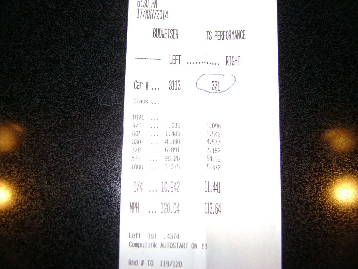

Well, let's see...I flubbed both time trials, had no clue for first round and went red for a SS/BA 9.teens opponent lol. How was your day?
http://i434.photobucket.com/albums/q...ps3778801a.jpg
I've just about pegged this on the convertor going south. How else does a car go from 1.45 60' to this? Funny thing is it is consistently bad and the et's get quicker. It sure is messing with my lights. The car just doesnt have that "snap" any longer at launch...we are going to do a convertor swap to confirm. Thinking maybe the convertor is tightening up, slipping less resulting in the decrease in et and more mph???

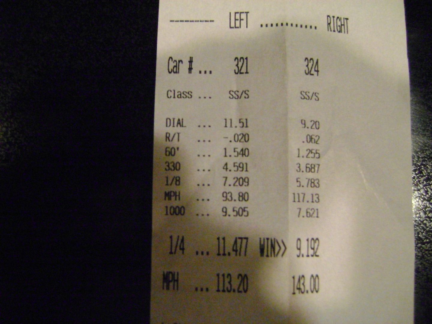

There wasnt anything obvious...the carb still runs like gangbusters on top. I have the metric/convertor back in the car now just waiting on the carb(s) to come back from KY.
Here is a timeslip from the previous weekend...you can see where the problem is from the sixty foot time. The carb is working great on top.
http://i434.photobucket.com/albums/q...ps604c8917.jpg
