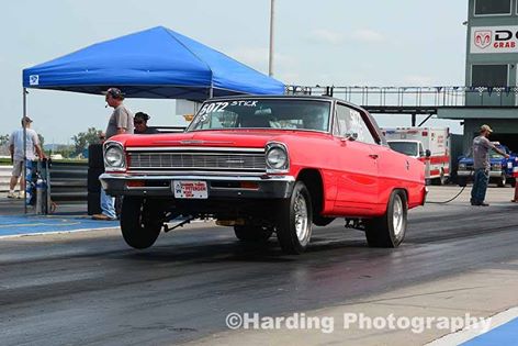

Paul Merolla 07-21-2014 05:25 PM
Re: Fresh rebuild, oil everywhere
1 Attachment(s)
Originally Posted by Sean Marconette (Post 438724)
Paul,
Will you be at the divisional this weekend?
Hope to see you there. Although it might be a little bit warmer than we had in Earlville!
Sean
Yes, Sean - we're planning on getting to Topeka on Thursday evening. I'll keep an eye out for you.
My first divisional, so I'm now forced to put at least a few stickers on! It's gonna be tough for me to do!
Here's a pic from Saturday....
Attachment 24841
Sean Marconette 07-21-2014 08:46 PM
Well I completely understand the sticker thing! That's what windows are for! All you need is the Lucas and NHRA. At a D4 race I had to put on the Jegs All Stars. Don't worry about the stickers until tech. Tech will make sure you have what is required. We will be looking for you as well.
As for the front end. It would be helpful to post what you have done to the front and rear suspension, what shocks and settings too.
Sean
