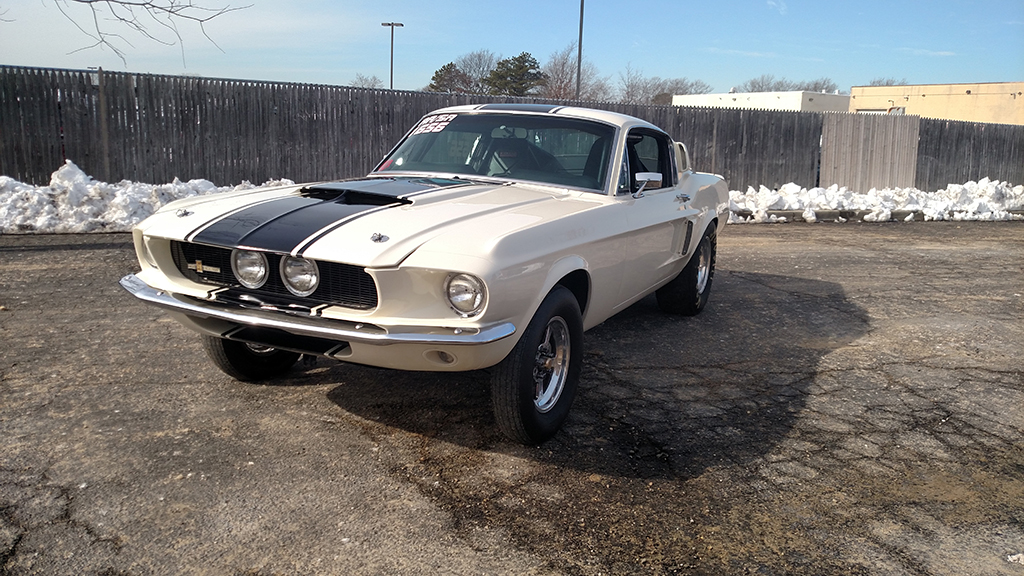

Ken Miele 02-07-2016 09:39 PM
Re: My 67 Shelby updates
2 Attachment(s)
Latest update for the Shelby was a much need paint job. I could not decide what color to go with, so I went with Wimbledon White with a modified version of the Super Snake stripes that come on a one off 67 427 Shelby. Check out some more photos at the link below. The body and paint was done by Eric Bardekoff. Many of you on the east coast know Eric and his Dad Jeff. Eric is the owner of EB Custom Works, and I can tell you his work is amazing.
Check out his website and the other builds he is working on. Eric is also a sponsor of Class Racer.
http://ebcustomworks.com/ebcustom/?p...io=1967-shelby
Rory McNeil 02-08-2016 02:12 AM
Looks great Ken, love the stock type paint scheme. Whats the story on the gold 67 Fairlane, is it also a race car?
