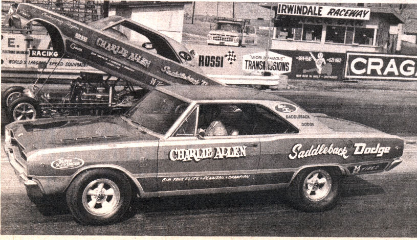

Charlie Allen was at the March 1968 'Hot Rod Magazine Championships at Riverside Raceway with that Dart.

We started working on the Charlie Allen dart again today and found something very interesting. As we were cutting out the after market wheel tubs we found a bolt that ran through the frame rail that we knew did not belong. We did not know what it was for and looked at our copy of american rodding from 1969 which has an article on this car. It turns out Charlie relocated the shocked to the front of the rear and mounted them vertical to reduce wheel hop. I feel it just helps to prove that this is really his dart because who does that kind of stuff.

* Mickey Thompson Wheels
* Super Scavenger Headers {by Mickey Thompson}
* Crower Cams

We were never able to get in touch with Charlie Allen. We are restoring it as he raced it including the paint. We want to be able to race the car so we will be making updates, keeping it more of a stock eliminator car now-a-days instead of super stock. I would love to be able to get in touch with him though.

Super Scavenger Headers ~ {by Mickey Thompson}
