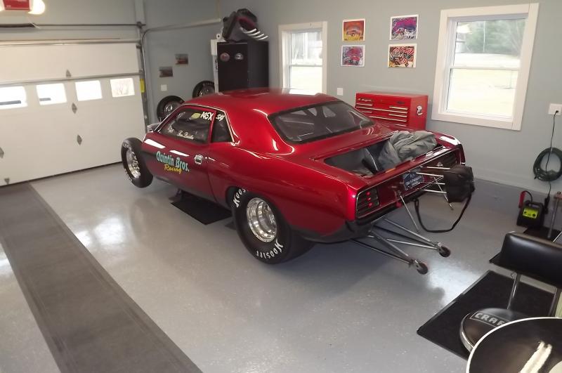

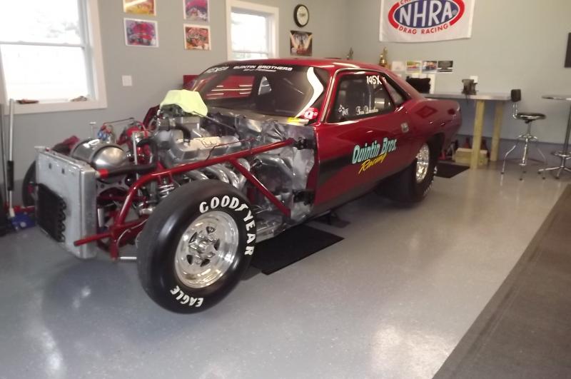

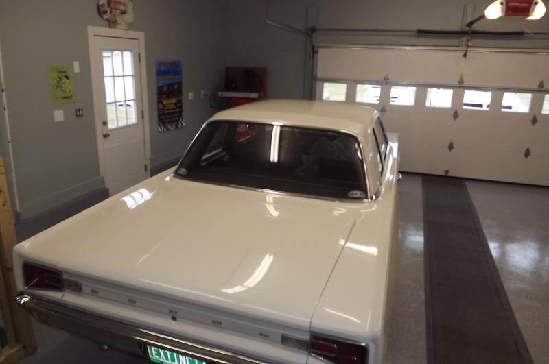

This Is Our Home shop On one of its cleanest days.
