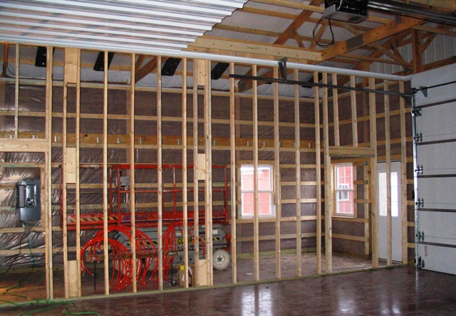

Originally Posted by Sean Marconette View Post
I am in the planning stages for a shop. What are the Pro's and Con's between an all steel building and a stick building? Door styles for overhead doors with wide spans. I am planning on housing a 48' trailer inside along with truck. Any help would be appreciated.
Thanks
Sean
Sean,

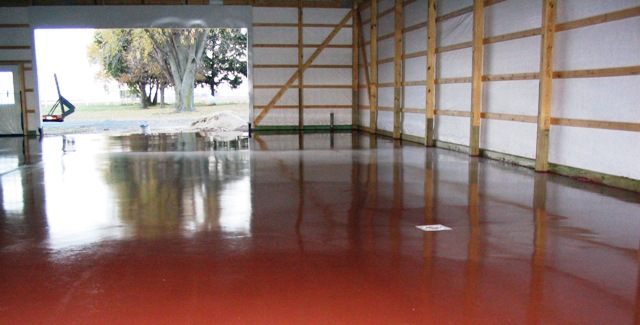

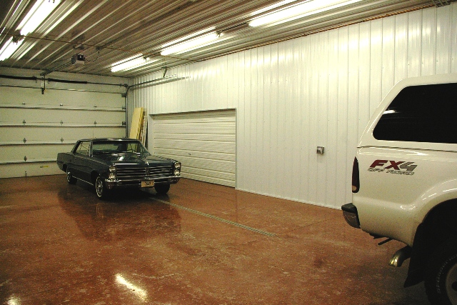

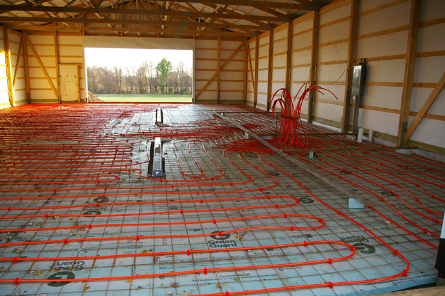

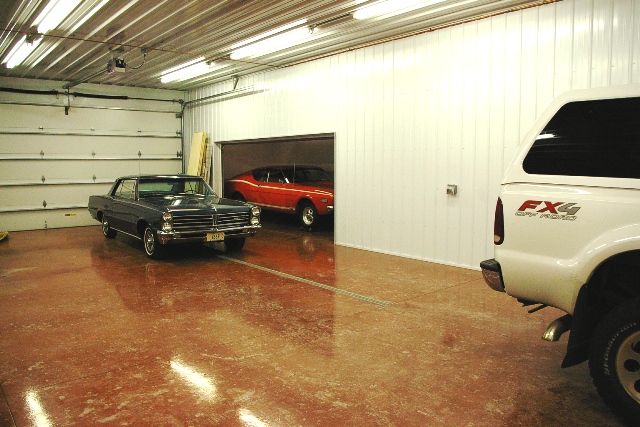

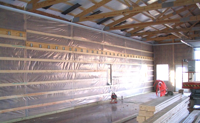

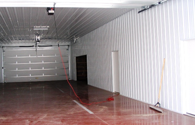

I am attaching some pics of a building I had built last year. It starts out as a 42 X 64 pole barn that becomes completely insulated in ceiling and walls. Along one wall(64 length) we put up a wall 9' from the side to have and area for office, mechanical, parts and a one stall garage (one car totally separated). This was studded and dry walled, with 8' ceilings but went up to 9' for the stall (7' door 2' rails). I had the white metal put on the shop area for easy clean up and to help everything be bright with light. The 9' area has the painted walls and wood trim like a stick built feel, but I can tell you that the insulation is so thick and works so well with the hot water heat running through the floor. I don't have total numbers, but I will bet I used less than 300 gal of propane last year and the heat was never less than 60 the whole time. Regarding doors, I put 2 10' X 20' one on each end so that drive thru is possible with my F-350 and a 28 tag. I wanted to go even longer and be able to unload the car from the trailer while inside, but I just didn't have the money for that. I hope this helps. Attached are some of the pics.
ID:	14350   Click image for larger version
ID:	14351   Click image for larger version
ID:	14353   Click image for larger version
ID:	14354   Click image for larger version

Your shop looks great, man am I jealous, I wish I could have built something the big. What did you do for the floor, it looks great. I need to do mine over and have not decided what to do yet. How about some pictures of the outside.

Ken,
A racer friend had this done in his and he told me to have the concrete guys put a "dye" in it. It did run about $900 more, but when the cost of the concrete was over $20k, that is a drop in the bucket. Color is good, but the pics don't show that all of the work that went on inside later affected the "shine" I was trying to achieve. The finish is great, wipes up oil and anti freeze even weeks later. It is not as slick when washing a car with the water and all but oil does make it slick. I have had a rep from the company visit and says that I need to put another chemical on it to soften it and release the moisture that might have gotten trapped, then it will harden again and shine.
This has slowed my progress as the fumes are very dangerous and I have daily use now for my truck. I have not put my lift in as I am waiting to do the floor as a whole.
Headaches. I will post some outside pics later.

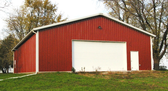

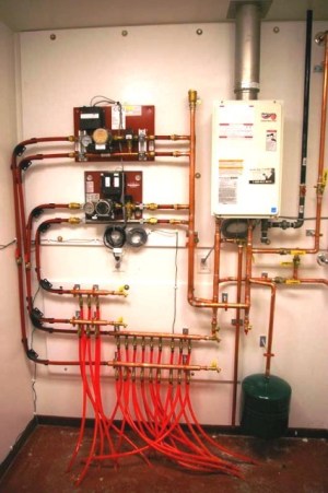

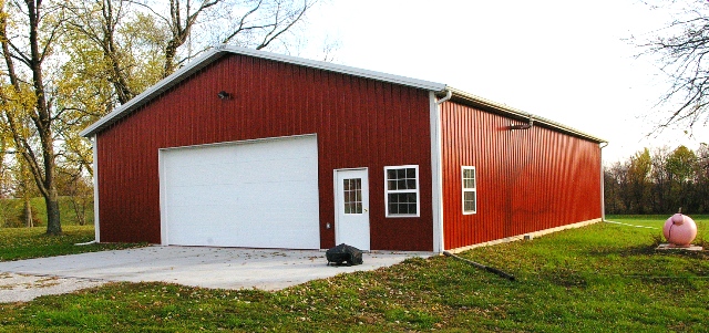

Some pics of the outside of the shop. Only windows are in the office area(less chance for curious eyes). Limited walk doors limit intruder entrances. There is a pic of my one car stall that is for the Pontiac, but has my Merc in it for now. It seals off so nothing can get on the car and there is little room to put anything else in if the urge should come up.
A couple of pics of my heating system. I so love the way it works.

Very nice, I like that you have a door in the front and the back. The heating system looks great. Not knowing much about this type of heating system, is it more efficient than say what I have. Mine is just a forced air heater hanging from the ceiling powered by natural gas.
