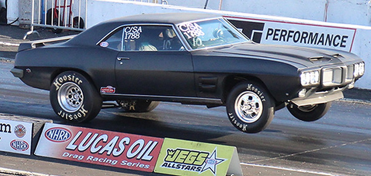

After Stock qualifying @ The Rock, Bruce Noland was #22, with a 10.534, which was .866 under. Robert Holmes was #31 @ .817 under.
https://www.dragracecentral.com/DRCS...er=30#indextop
In Stock E-1, Bruce cut a slow light & lost. But, apparently conditions were good there. He dialed 10.45 & ran 10.442, which is .958 under the 11.40 C/SA index.
There were several C/SA cars entered. Bruce had the quickest, in qualifying & elims.
https://www.nhra.com/results/2021/lu...ock-eliminator

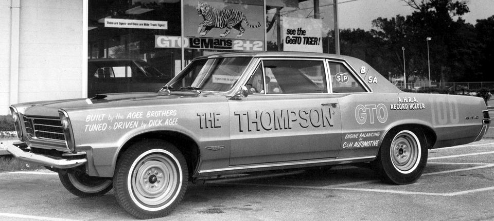

For another thread, I just looked back thru my pics of '65 GTO Stockers. Was searching for any pics of 2-speed auto trans Stockers.
To my surprise, I noticed that the car in a pic I'm familiar with is of a '65 GTO that ran B/SA. That means it had to run a 2-speed auto trans.
Also, either I never noticed before, or I noticed & it didn't really register with me, but, on the rear fender are the words: "AHRA Record Holder" !
I suppose the reason I haven't used the pic much is because the car appears to have a Tempest grill, instead of a GTO grill, as well as the wrong bumper. I assumed the car probably just ran at some local outlaw track. But, obviously, at some point, it was a serious legal AHRA Stocker. It was apparently sponsored by Thompson Pontiac.
Anybody here know anything about this car ?
Stan Weiss posted this quote. Don't know where he found it. Also don't know if the car had the wrong grill & bumper on it when the record was set, or not.
"...Dick Agee drove the Thompson GTO to a national record.
Agee's official elapsed time in the 1965 GTO was 13.30 seconds..."

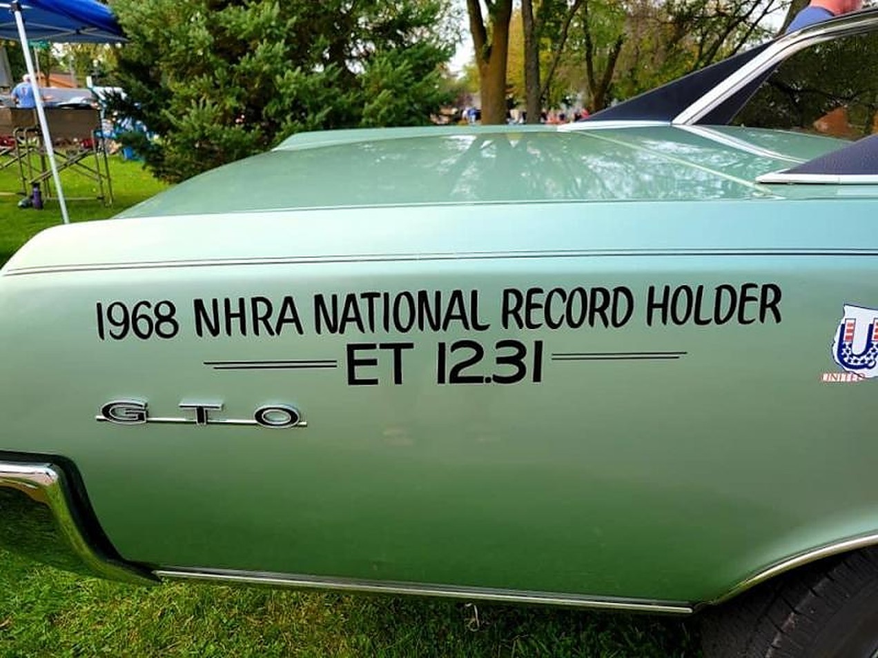

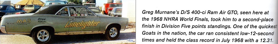

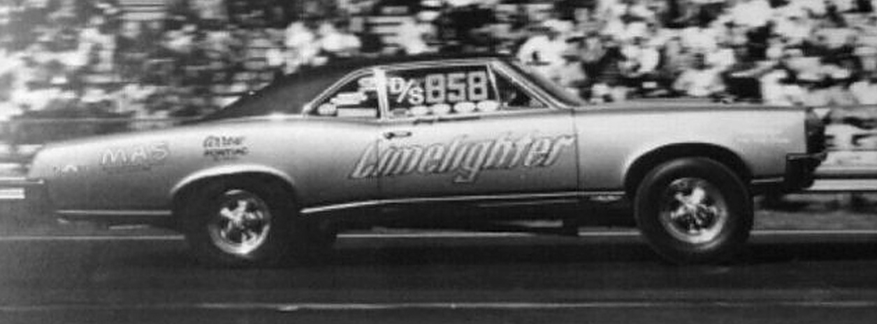

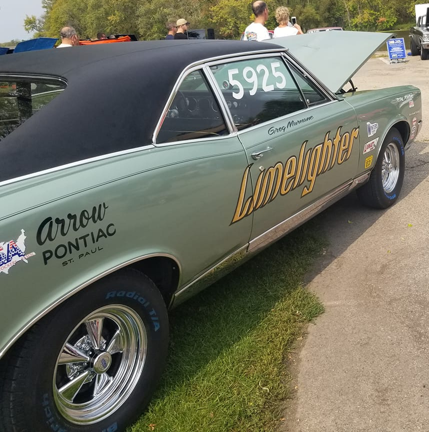

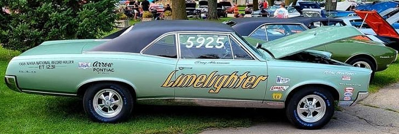

Just got these first 3 pics, which were made @ a recent car show.
It's the "Limelighter" '67 GTO Stocker. It was a nat record holder, back in '68.
It was driven by Greg Murnane. He was RU in season points, in NHRA div 5, in '68.

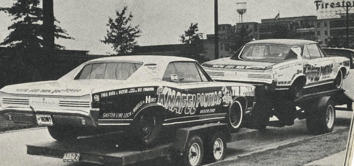

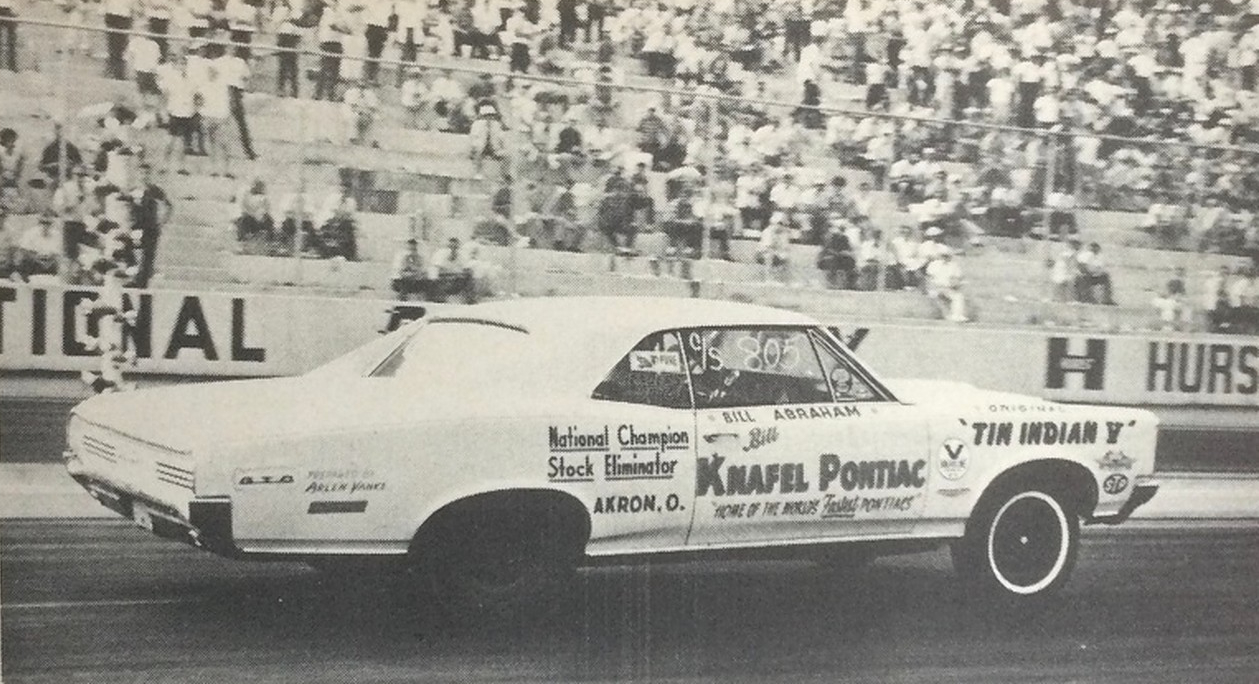

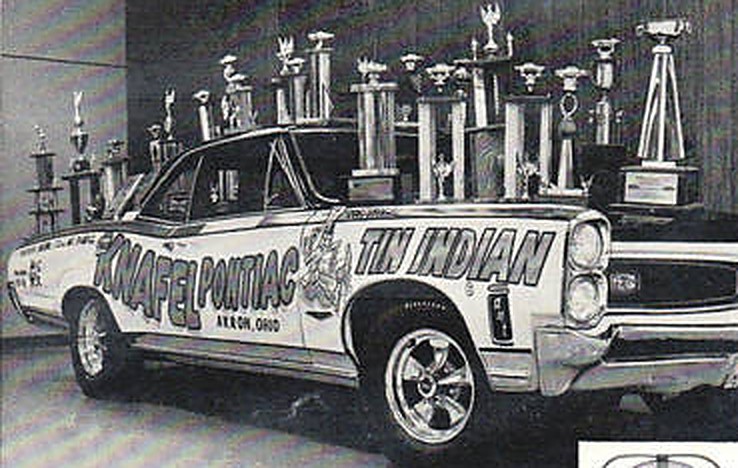

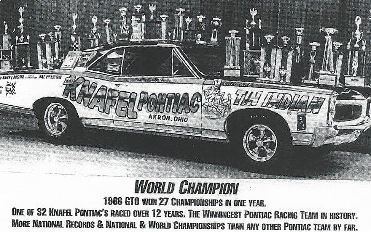

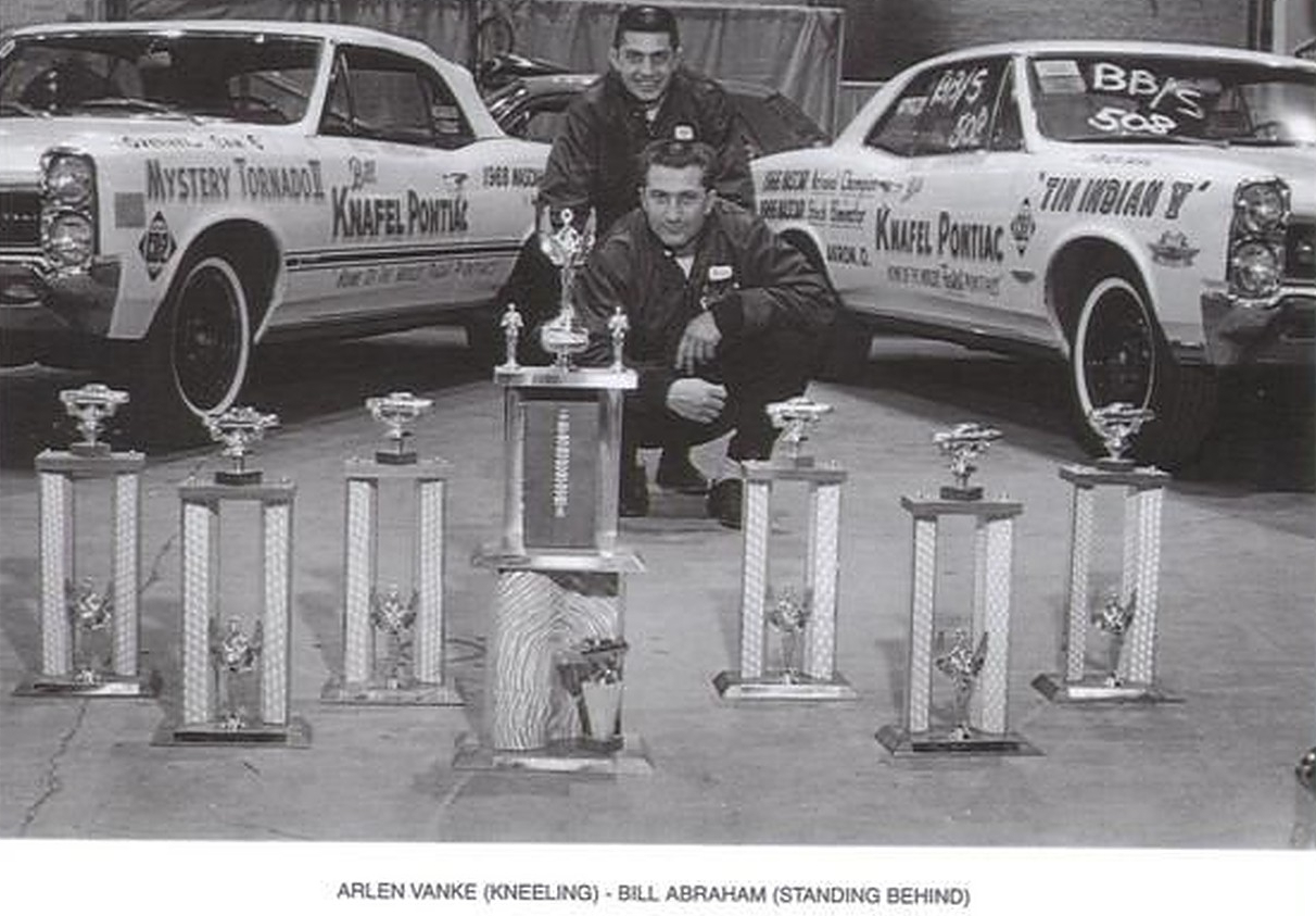

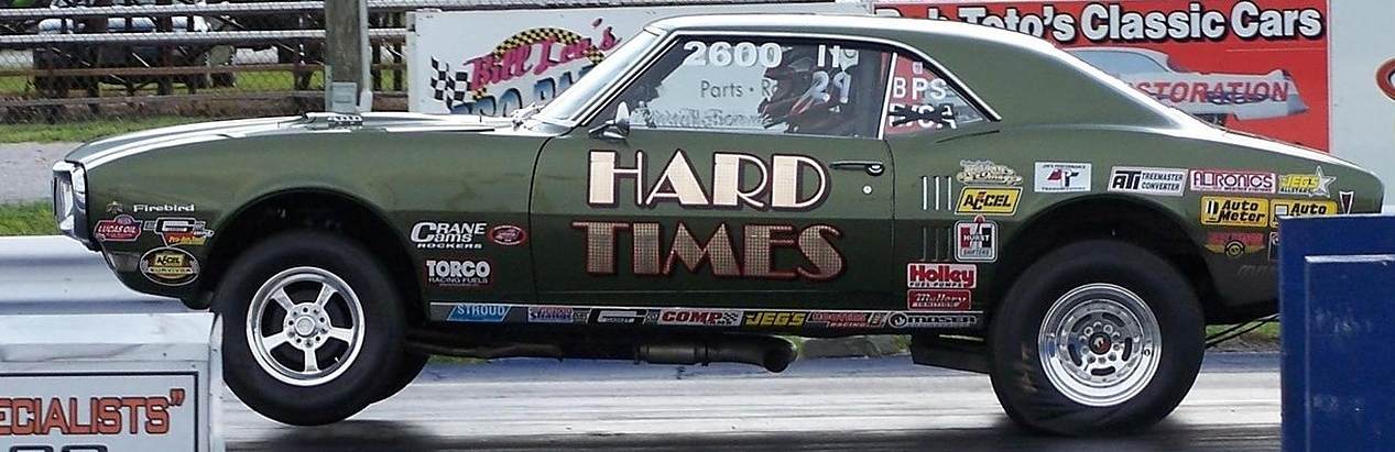

Just realized that I ID'd a pic wrong. When I saw a pic(pic #4 below) of a white '66 Knafel Pontiac, I thought it was one of the OHC cars that Knafel ran.
BUT, on closer examination of the pic, as well as noticing the same car in another pic(pic #5 below), I realized that the car is actually the original Tin Indian V '66 GTO. It has BB/S on it, in that pic. So, what class is that ?
I'd been thinking & posting that the GTO pictured with all the trophies was actually the car that won all the races.
I've also posted pics of the Knafel 2-car rig, with 2 '66 GTO's on it, with different paint schemes. Now I'm really confused.
So, were there actually 3 of these cars, all of which were raced in '66 ?
Was the trophy car actually the same car as in pic #4, just made later, when it had a different paint job ?
How many different GTO's are pictured below ?
Note: Don't count the OHC six ragtop.

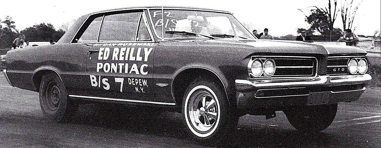

Recently found this pic of a '64 GTO Stocker.
It appears to be a dealer sponsored car, that ran AHRA, in the F2 B/S class. Don't have any performance numbers.
Anybody know the car ?

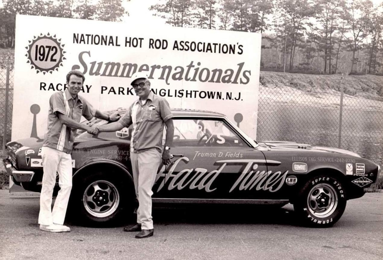

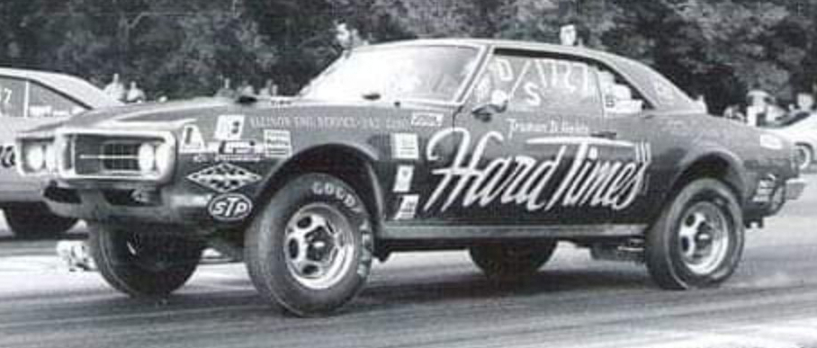

Talkin about all the Stock rules changes back in the early '70's, on another thread, reminded me of all the different classes Truman Fields ran, in '68 Birds.
I have pics of his Birds running A, B, C, & D-Stock, as well as B/PS. He set records in several classes. Don't know how many different records he set with his Birds. He raced '68 Birds for a lot of years.
As I've probably mentioned a few times, he was my 1st Pontiac hero !
I'll sort out some pics of his Birds running different classes, & post 'em when I have time.

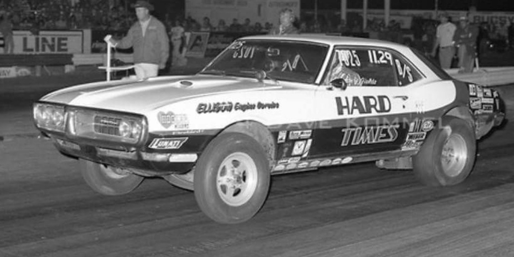

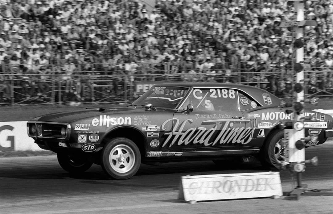

Name:	1 - '72 A-S Class Win .jpg
ID:	61254   Click image for larger version
Name:	2 - B-S White .jpg
ID:	61255   Click image for larger version
Name:	3 - C-S T. Fields .jpg
