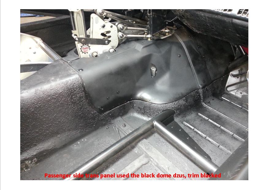

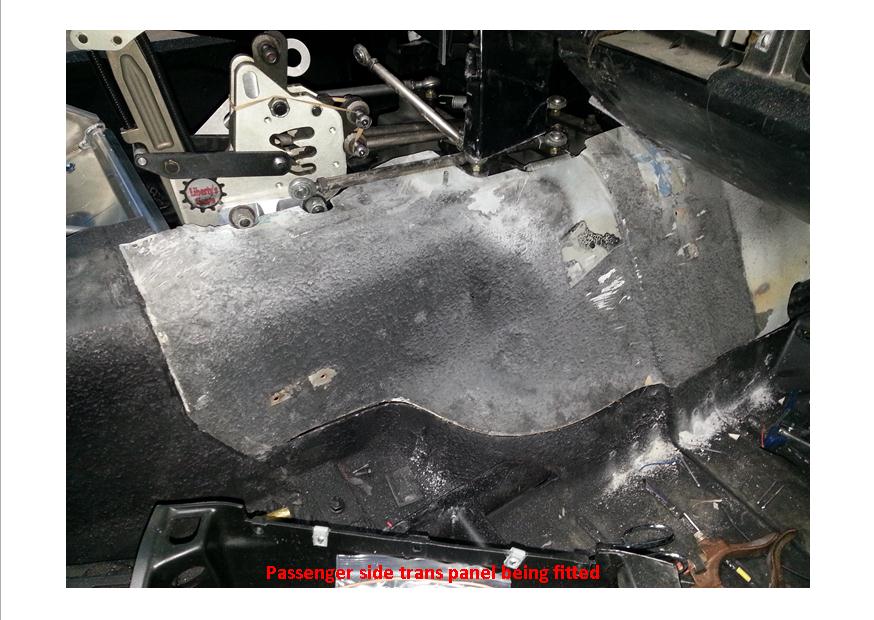

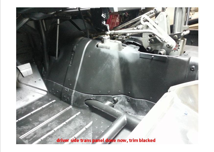

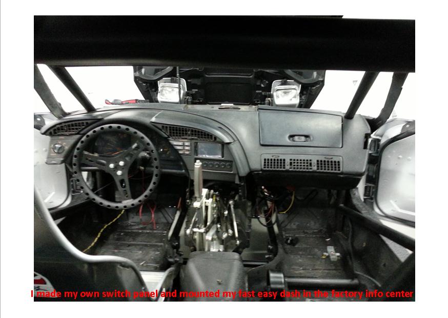

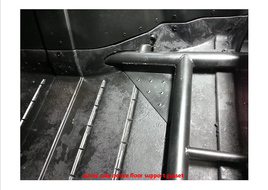

some of the inside items, getting interior in shape.

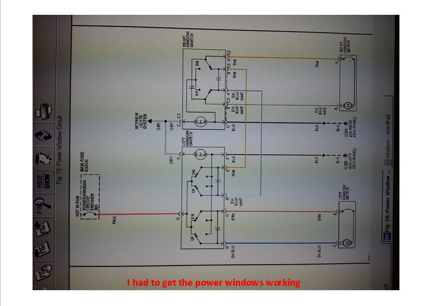

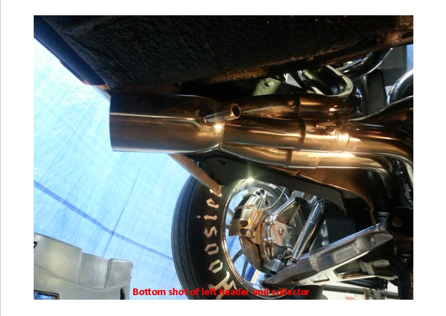

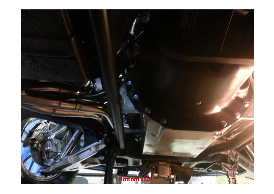

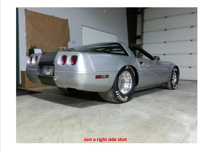

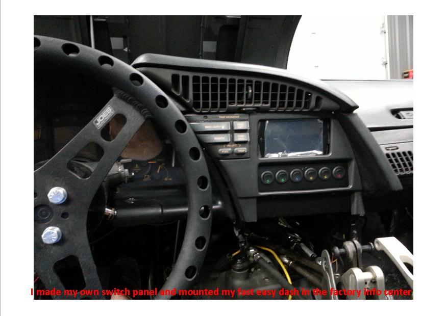

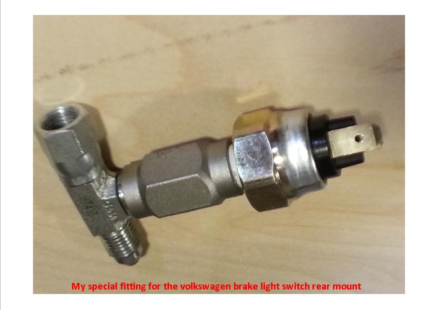

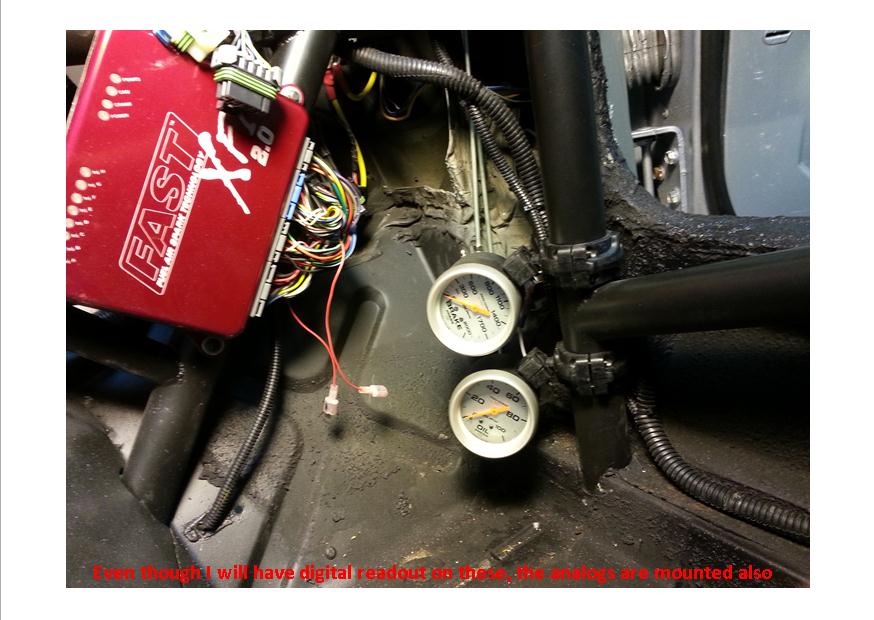

rear mount brake light switch (cause I wanted it)

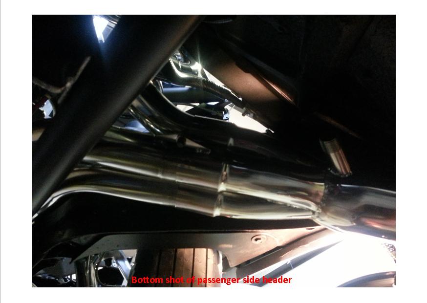

3 pictures of bottom headers

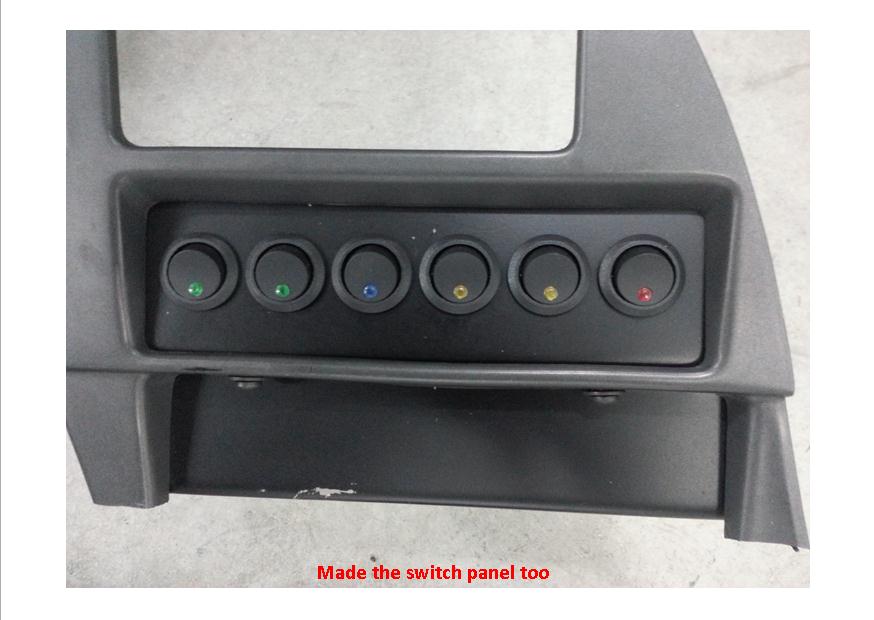

my brake pressure and oil pressure mounted, not monitored on my E-dash

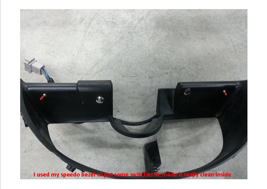

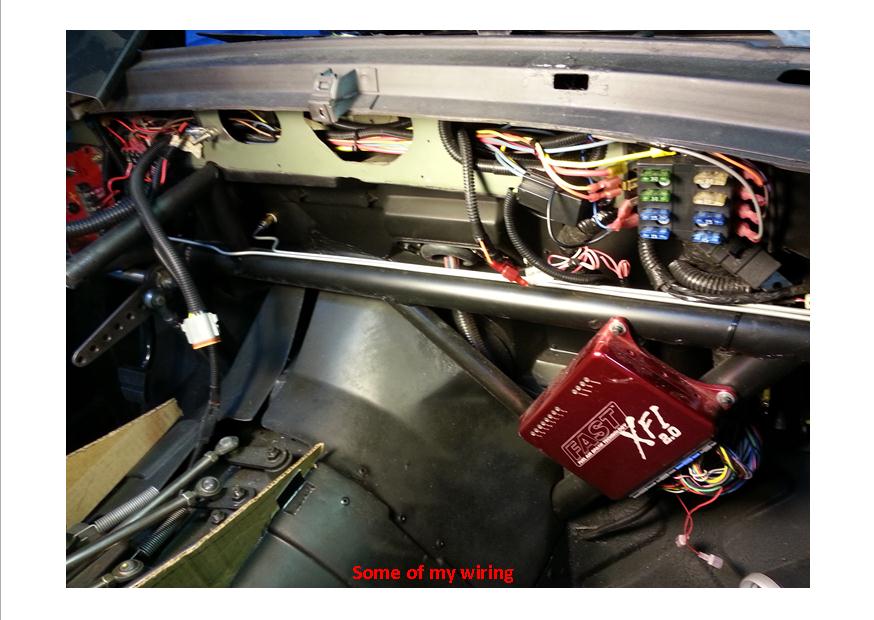

some of the wiring

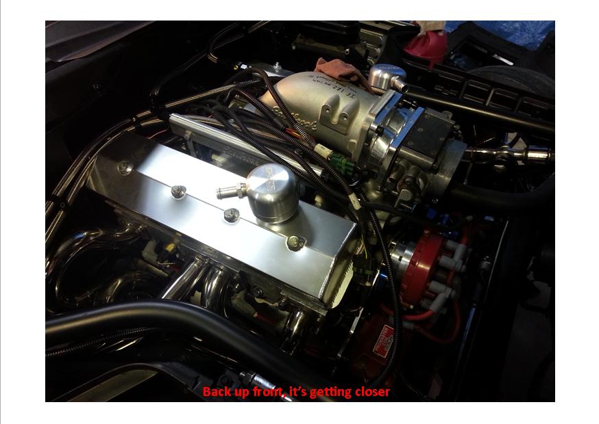

underhood shot
couple pictures of the car, still not finished here but getting closer

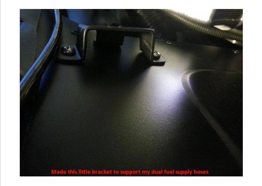

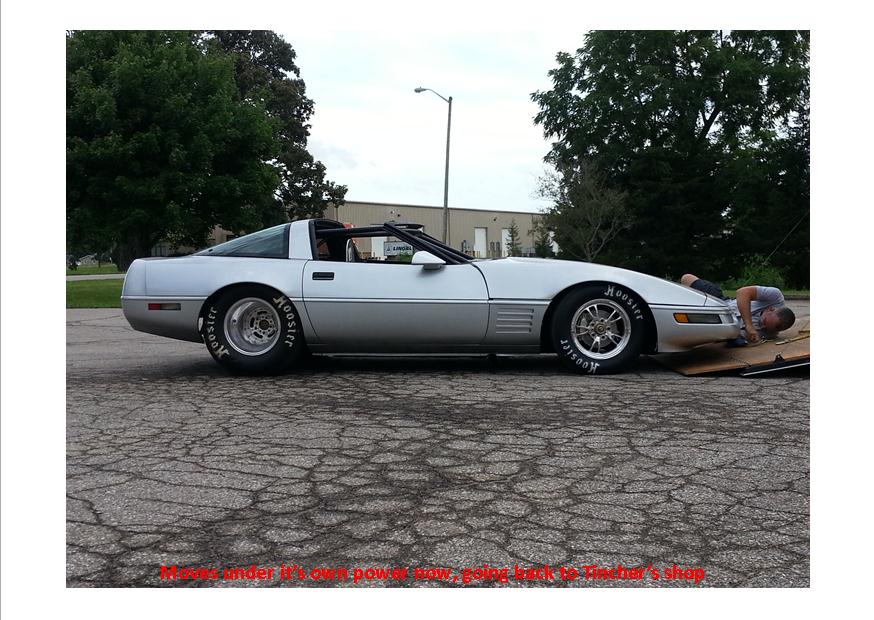

fuel line bracket, it took me a minute to make this little bracket with 3 legs on an angle
1 photo when the car was going back to David Tincher's shop
2 photos of Door Slammer race, Tincher drove it

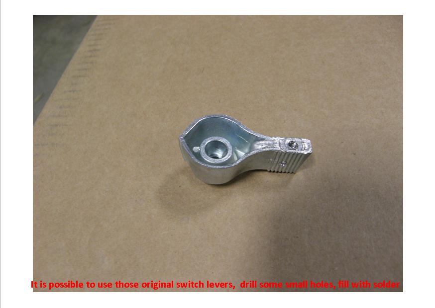

making the little lever that comes with cut-off usable for threaded rod style uni-ball connection. I filled with solder after drilling it with small holes. drilled and tapped 10-32, put a screw all the way through and used a flat washer and a jam nut. It worked as good as a billet one.
