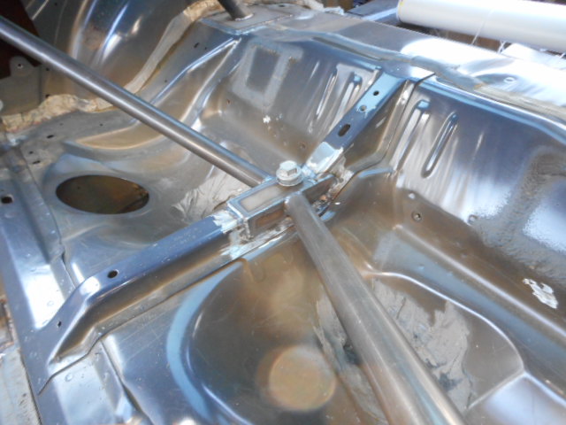

Where the upper control arm mounting bracket bolts we reinforced the floor on the inside of the car. We could not get our DA Strange front shocks loose enough so we put some Santuff front springs in and it helped the weight transfer. Also Calvert did make some parts for the front lower control arms. Looking good.

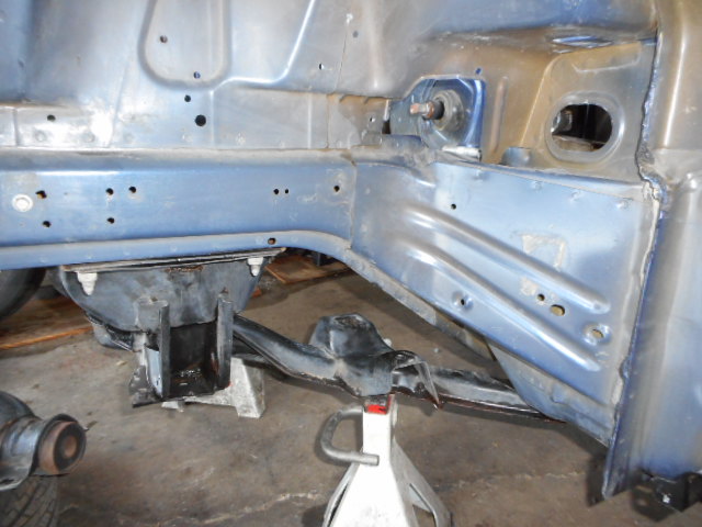

Thanks for the info Kirk, Mike @ MPR did reinforce the UCA mount, here is a pic.

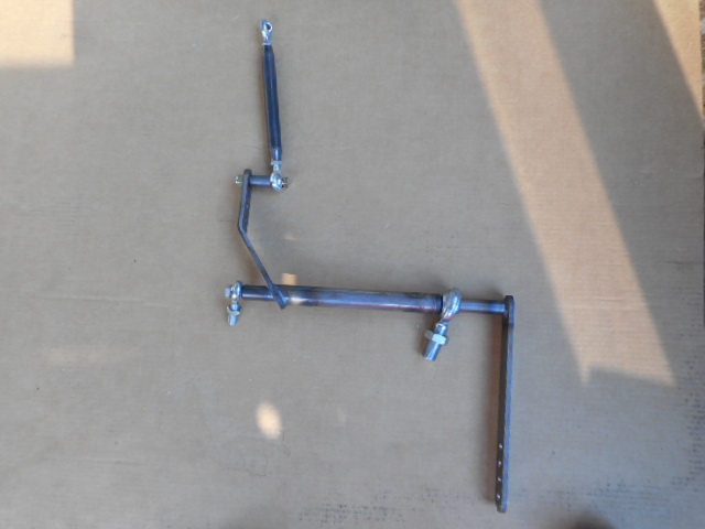

Another piece of the puzzle is this clutch linkage fabbed by Mike @ MPR, it is based on a Brad Zaskowski design that was built for George Wright. Any CJ racers needing one can contact Mike.

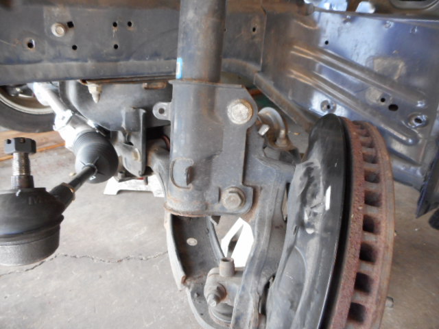

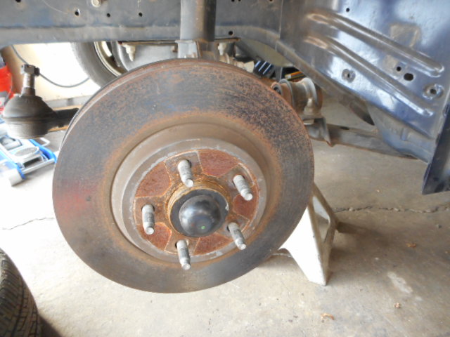

Finally have all the chassis components.Here are a few pics from disassembly.
ID:	44192   Click image for larger version
ID:	44193   Click image for larger version
