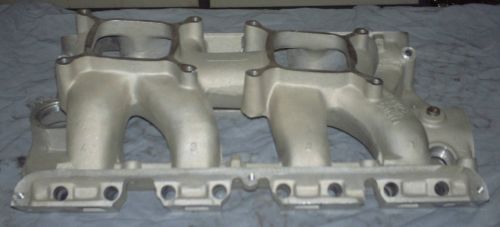

Best factory FoMoCo 2-4V FE intake ever made.
The infamouns C8AX "Tunnel Wedge" still very popular today.
