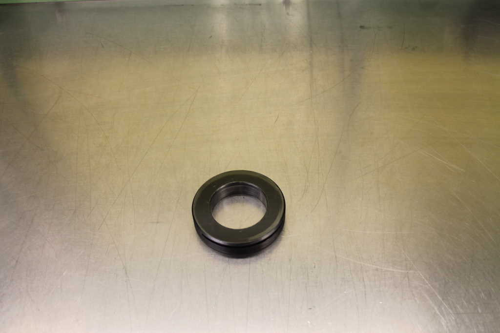

It looks like a setting fixture for a cap grinder, I don't have one but it looks like a nice piece. I think you made reference to it in an early post on removing taper from rod bores.
YES! this tool is used for dialing in the cap grinder.

Larry
How about this one: What is it, and whats it used for?

Answer can be found in post #10, don't forget the Allen wrench to make AG300 read the largest when using. I prefer to have final adjustment on screw on the upward motion so the lash in the screw is taken up. Use the smaller ring on smaller holes.
Be easy on me I do most of my stuff in my backyard, but I do enjoy learning
Right again! I think you might know a thing or two, obviously you know your way around a machine shop. Harold Bettes speaks highly of you, we would like you to stop by the shop in your coast to coast travels!
